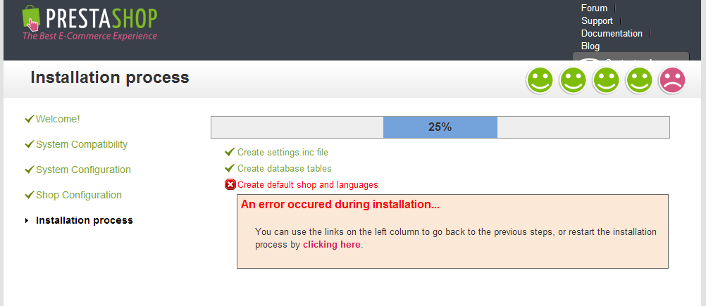

thehandlestudio Posted June 8, 2012 Share Posted June 8, 2012 (edited) Hi Team, I have downloaded the latest version of the 1.5 RC and trying to get this to install on a test server, so everything is fresh and new ( domain & database) All setting are correct when going through the installation until you get to the last screen which there is a screen shot for you to see, I am getting an error with the default shop and languages... Any help or comments on this please ??? Kind Regards, Mark. SOLVED = this was solved because my host had to enable copy() function on the server Edited July 18, 2012 by thehandlestudio (see edit history) Link to comment Share on other sites More sharing options...

mooshi Posted June 9, 2012 Share Posted June 9, 2012 Hi! there It appears to be only happening on Firefox, installs perfectly on Chrome. I had exactly the same problem as Mark. Link to comment Share on other sites More sharing options...
thehandlestudio Posted June 11, 2012 Author Share Posted June 11, 2012 Mine was with Internet Explorer. Regards, Mark. Link to comment Share on other sites More sharing options...

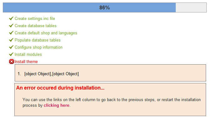

BillyHardcore Posted June 11, 2012 Share Posted June 11, 2012 Mine was a bit further ahead. At 86% I get a theme error Link to comment Share on other sites More sharing options...

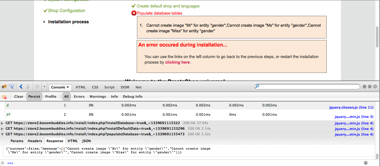

lynnetted Posted June 14, 2012 Share Posted June 14, 2012 (edited) In reply to your message: As Raphael, one of our developer, said in the French forum, to give us as much details as possible it would be best to install Firebug and to follow these steps: - Open Firebug before installing PrestaShop. - Select the console tab. - Start the installation with Firebug still open. You should see many links in the console tab. Once you have the error message click on the last one. You should have some data, copy and past it in this topic. Thank you For Firebug information see the attachment below. I see that Firebug can be configured many ways, let me know if you need different information. We are trying to install 1.5RC on our test site store2.bosombuddies.info. The Server information below is from our other test site(www.bosombuddies.info) which is on the same server: Server information Prestashop version: 1.4.6.2 Server information: Darwin Darwin Kernel Version 11.4.0: Mon Apr 9 19:32:15 PDT 2012; root:xnu-1699.26.8~1/RELEASE_X86_64 x86_64 Server software version: Apache/2.2.21 (Unix) mod_ssl/2.2.21 OpenSSL/0.9.8r DAV/2 PHP/5.3.10 with Suhosin-Patch PHP version: 5.3.10 MySQL version: 5.5.13-log Store information Shop URL: https://www.bosombuddies.info/ Current theme in use: BB_prestashop Mail configuration Mail method: You are using the PHP mail() function. THANKS! Lynnette Edited June 14, 2012 by lynnetted (see edit history) Link to comment Share on other sites More sharing options...
lynnetted Posted June 14, 2012 Share Posted June 14, 2012 In reply to your message: For Firebug information see the attachment below. I see that Firebug can be configured many ways, let me know if you need different information. We are trying to install 1.5RC on our test site store2.bosombuddies.info. The Server information below is from our other test site(www.bosombuddies.info) which is on the same server: Server information Prestashop version: 1.4.6.2 Server information: Darwin Darwin Kernel Version 11.4.0: Mon Apr 9 19:32:15 PDT 2012; root:xnu-1699.26.8~1/RELEASE_X86_64 x86_64 Server software version: Apache/2.2.21 (Unix) mod_ssl/2.2.21 OpenSSL/0.9.8r DAV/2 PHP/5.3.10 with Suhosin-Patch PHP version: 5.3.10 MySQL version: 5.5.13-log Store information Shop URL: https://www.bosombuddies.info/ Current theme in use: BB_prestashop Mail configuration Mail method: You are using the PHP mail() function. THANKS! Lynnette Here's the headers from FireBug: Cache-Control no-store, no-cache, must-revalidate, post-check=0, pre-check=0 Connection Keep-Alive Content-Length 186 Content-Type text/html; charset=utf-8 Date Thu, 14 Jun 2012 16:57:00 GMT Expires Thu, 19 Nov 1981 08:52:00 GMT Keep-Alive timeout=15, max=96 MS-Author-Via DAV Pragma no-cache Server Apache/2.2.21 (Unix) mod_ssl/2.2.21 OpenSSL/0.9.8r DAV/2 PHP/5.3.10 with Suhosin-Patch X-Powered-By PHP/5.3.10 Request Headers Accept application/json, text/javascript, */*; q=0.01 Accept-Encoding gzip, deflate Accept-Language en-us,en;q=0.5 Connection keep-alive Cookie install_de491c6ed8c2f3118bd02d2d6cd570f4=ulfapcdo6b0kpld4it0t1jvmbs6u6q43; install_6666cd76f96956469e7be39d750cc7d9=9oi1kots6858d1g40ganr8t5tkk5cvp1; 9ffb800e76372160cbb02415dccd7dec=TkHOKEl5Gp2EMt41Fdo9EkN6dymbXbyHf4FFFe35Yt5sIuvoEp1MT5kNFtRy9cXJzON5%2FGJp%2BEs%2BcL1kG3FC6g%3D%3D000059; 0ce3beb550fcd80fa4e2751c91d13df6=GlviyiwkHbP1U8esFuI%2BJbapGoUIdnawXOQ48q0prOk%3D000019 DNT 1 Host store2.bosombuddies.info Referer https://store2.bosombuddies.info/install/index.php?restart=true User-Agent Mozilla/5.0 (Macintosh; Intel Mac OS X 10.7; rv:13.0) Gecko/20100101 Firefox/13.0 X-Requested-With XMLHttpRequest Link to comment Share on other sites More sharing options...

thehandlestudio Posted June 15, 2012 Author Share Posted June 15, 2012 (edited) I have just tried again with firebug enabled and this is what I get GET www*********************************** 200 OK 506ms ParamsResponseJSON {"success":true,"message":""} GET www************************************* 200 OK 905ms ParamsResponseJSON {"success":true,"message":""} GET www************************************* 200 OK 958ms ParamsResponseHTML <br /> <b>Warning</b>: SIMULATION - copy() has been disabled for security reasons in <b>/home/handlest/test_html/install/models/install.php</b> on line <b>322</b><br /> <br /> <b>Warning</b>: SIMULATION - copy() has been disabled for security reasons in <b>/home/handlest/test_html/install/models/install.php</b> on line <b>322</b><br /> <br /> <b>Warning</b>: SIMULATION - copy() has been disabled for security reasons in <b>/home/handlest/test_html/install/models/install.php</b> on line <b>322</b><br /> <br /> <b>Warning</b>: SIMULATION - copy() has been disabled for security reasons in <b>/home/handlest/test_html/install/models/install.php</b> on line <b>322</b><br /> <br /> <b>Warning</b>: SIMULATION - copy() has been disabled for security reasons in <b>/home/handlest/test_html/install/models/install.php</b> on line <b>322</b><br /> {"success":true,"message":""} Regards, Mark. Edited June 15, 2012 by thehandlestudio (see edit history) Link to comment Share on other sites More sharing options...
Raphaël Malié Posted June 18, 2012 Share Posted June 18, 2012 @thehandlestudio : hello, you have this problem because the function copy() is disabled on your server, and without this function a lot of thing wont work on your PrestaShop. So I suggest ou fix this problem : open the php.ini file, and remove "copy" of the list of disabled functions. Then restart Apache. Regards Link to comment Share on other sites More sharing options...
