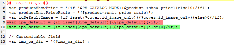

phrasespot Posted June 13, 2012 Share Posted June 13, 2012 (edited) So does this mean that I download ver 1.4.5.1 from here? No, it is http://svn.prestashop.com/trunk. Don't worry about it though, change is attached to this post; removal in red, addtion in green. File being changed is /themes/your_theme/product.tpl Also, do you know how to allow non registered users to join the notification for out of stock items? This is already possible. They just need to enter theiir email address and it should work, sans the problem discussed above. Edited June 13, 2012 by phrasespot (see edit history) Link to comment Share on other sites More sharing options...
lalaaaa Posted June 14, 2012 Author Share Posted June 14, 2012 No, it is http://svn.prestashop.com/trunk. Don't worry about it though, change is attached to this post; removal in red, addtion in green. File being changed is /themes/your_theme/product.tpl This is already possible. They just need to enter theiir email address and it should work, sans the problem discussed above. Hi Phrasespot, the above change did not solve the problem.. I still get the error "There is not enough product in stock" when I hit enter on the keyboard after entering the email.... T_T Link to comment Share on other sites More sharing options...
phrasespot Posted June 14, 2012 Share Posted June 14, 2012 Hmm. I still see the problem there. If you are sure you applied the fix correctly, delete all files from /tools/smarty/compile/ directory except index.php and try again. Link to comment Share on other sites More sharing options...
lalaaaa Posted June 14, 2012 Author Share Posted June 14, 2012 Hmm. I still see the problem there. If you are sure you applied the fix correctly, delete all files from /tools/smarty/compile/ directory except index.php and try again. YAY! It works now! Thanks alot! But I still can't get non registered users to join the notification for out of stock items... It just wont show up in my database..... or in my or my customer out of stock module... T__T Link to comment Share on other sites More sharing options...

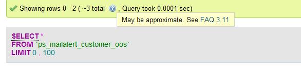

lalaaaa Posted June 15, 2012 Author Share Posted June 15, 2012 (edited) Long answer, load your site in an IDE, set a debug point, submit the form and step through until you find the problem. Short answer, find a developer. Erm... Ok, what's IDE? Anyways, there's this message that showed in my database (Refer to picture attached). Can I get it to show everything instead of just approximate results? However, "3.11 The number of records for InnoDB tables is not correct. phpMyAdmin uses a quick method to get the row count, and this method only returns an approximate count in the case of InnoDB tables. See$cfg['MaxExactCount'] for a way to modify those results, but this could have a serious impact on performance." what Serious impact on performance will there be? Edited June 15, 2012 by lalaaaa (see edit history) Link to comment Share on other sites More sharing options...
