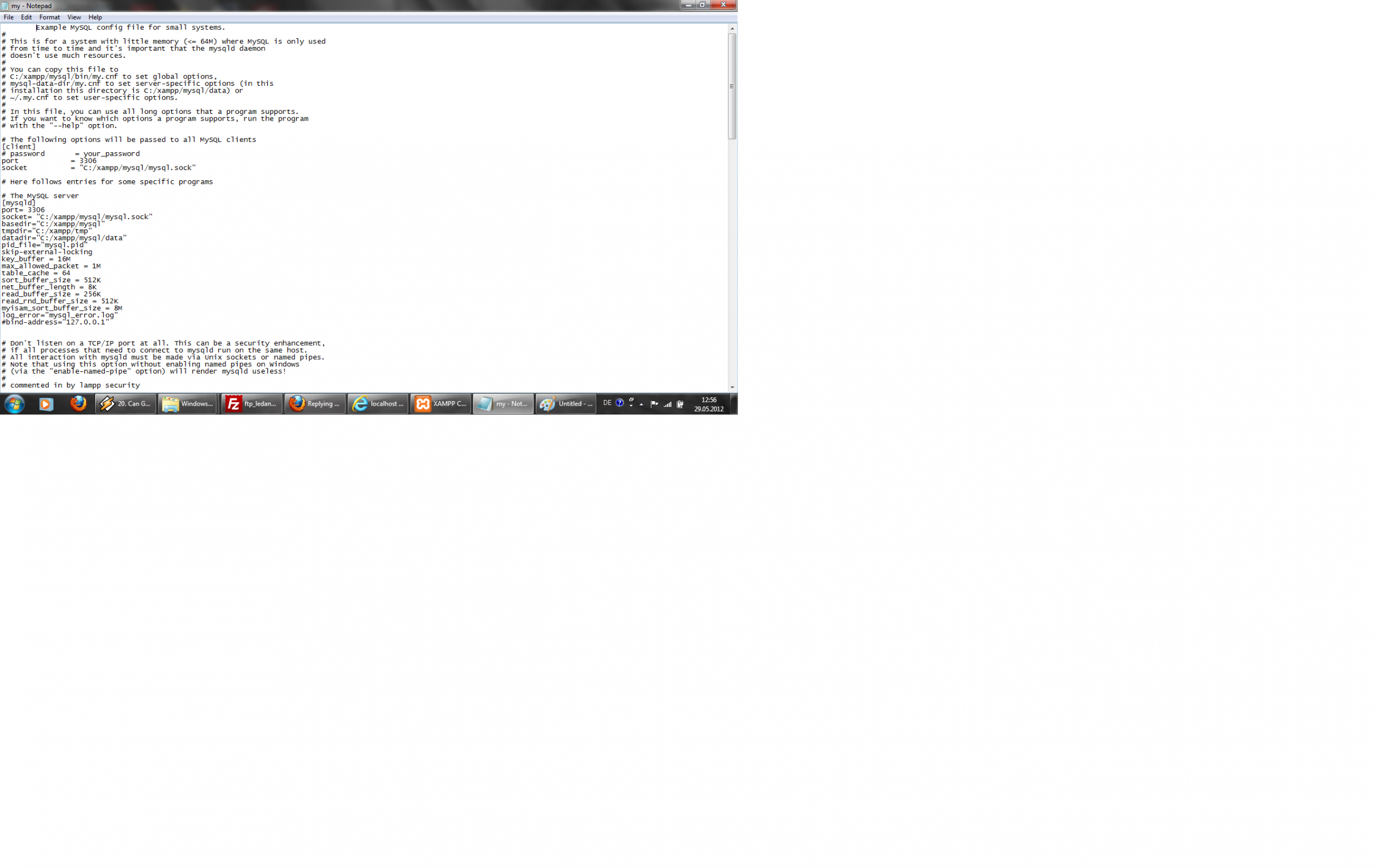

hberenturk Posted May 29, 2012 Author Share Posted May 29, 2012 i use xampp for mysql server and php ; in xampp directory there is a tmp but inside of mysql file there is no tmp file. In my.cnf file it writes that ' socket= "C:/xampp/mysql/mysql.sock" ' but in mysql files as i said there is no mysql.sock file.As i know mysql creates mysql.sock automatically am i right or should i copy it to the folder? Link to comment Share on other sites More sharing options...
hberenturk Posted May 29, 2012 Author Share Posted May 29, 2012 Here is the screenshot of my my.cnf file , so i think i should change something inside of this.Is anyone has an idea how can i fix this mysql.sock problem ? Link to comment Share on other sites More sharing options...
MEG Venture Posted May 29, 2012 Share Posted May 29, 2012 As you say, the mysql.sock should be automatically created once your server is up and running. I don't know where it is located but yhe autostart settings socket can be off. Consequently, you may consider to uninstall and reinstall the mysql server. Link to comment Share on other sites More sharing options...
hberenturk Posted May 29, 2012 Author Share Posted May 29, 2012 is there a possible solution without uninstall mysql server? There is no mysql.sock file and i have to fix it by modifying my.ini file as i think but couldnt achieve since now.. can it be related with port crash ? like 1 week im stuck with this problem.. Link to comment Share on other sites More sharing options...
