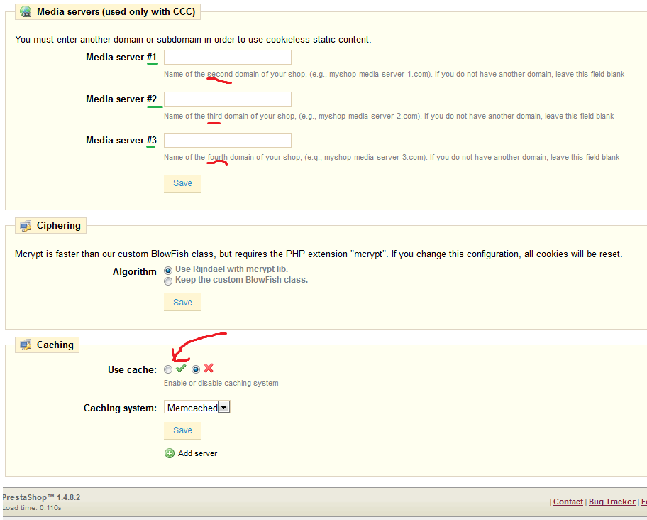

adamus007p Posted May 26, 2012 Share Posted May 26, 2012 (edited) Since presta 1.4.x PS allow to use Media servers (used only with CCC) I was trying to find on the forum/Internet/docs answer how to configure it, how to use it. http://docs.prestash...ces-Performance the explanation of CCC server is: Media servers Enable you to redirect part of your traffic (media files, for instance) to other servers under your control, through other domains or sub-domains. I it not enough to me, so that is my question it, how it works and how to configure it? 1. Do i need clone my shop (all data and mysql database) on 2nd server and point there other domain or subdomain? 2. Do i need clone my shop (only data or some part of data, like img) on 2nd server and point there other domain or subdomain? 3. Can I point other domain or subdomain to my existing shop and it will increase also speed of loading my shop? Please tell me how it is works and how to configure it. Edited May 26, 2012 by adamus007p (see edit history) Link to comment Share on other sites More sharing options...

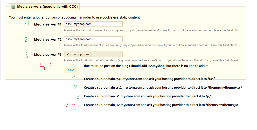

adamus007p Posted June 4, 2012 Author Share Posted June 4, 2012 (edited) 5. Create sub-domains for Javascript files and CSS files Create a sub-domain js1.mystore.com and ask your hosting provider to direct it to /js/ Create a sub-domain js2.mystore.com and ask your hosting provider to direct it to /theme/mytheme/js/ Create a sub-domain css1.mystore.com and ask your hosting provider to direct it to /css/ Create a sub-domain css2.mystore.com and ask your hosting provider to direct it to /theme/mytheme/css/ These 4 sub-domains will allow your visitors to load more files at the same time. Basically, a web-browser is limited to 8 parallel downloads. Each sub-domain is adding 8 new parallel downloads, so the total would be 40 (Main domain + 4 sub-domains). but in Prestashop there are only 3 lines to write subdomains other question is if cache need me enabled? see attachment Edited June 4, 2012 by adamus007p (see edit history) Link to comment Share on other sites More sharing options...

adamus007p Posted June 7, 2012 Author Share Posted June 7, 2012 pel024 I wrote my post here: http://www.prestashop.com/blog/en/10-best-tips-to-speed-up-your-prestashop-store-3/#comment-1899 I was contacting with developers, but I have fealing that nobody know how it work there are different informaction: point subdomains to same root shop folder point subdomains to: Create a sub-domain js1.mystore.com and ask your hosting provider to direct it to /js/ Create a sub-domain js2.mystore.com and ask your hosting provider to direct it to /theme/mytheme/js/ Create a sub-domain css1.mystore.com and ask your hosting provider to direct it to /css/ Create a sub-domain css2.mystore.com and ask your hosting provider to direct it to /theme/mytheme/css/ with PS 1.4.3 not works, I will update shop and try to do test with new version. Link to comment Share on other sites More sharing options...
