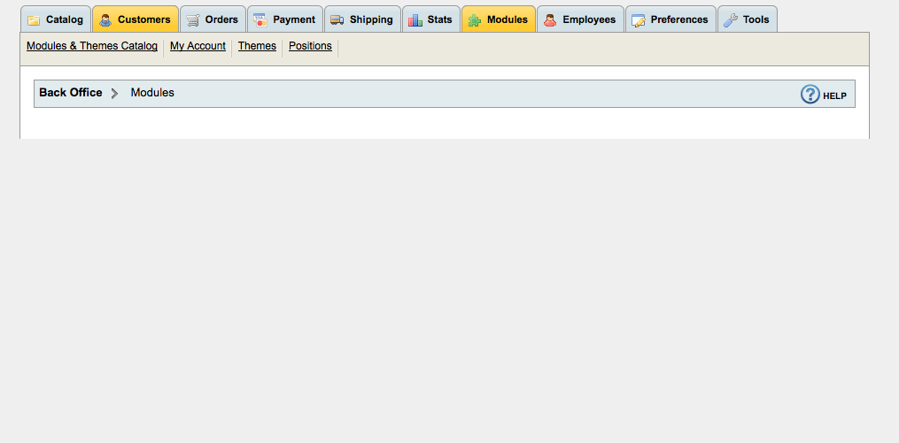

Durkin Posted May 24, 2012 Share Posted May 24, 2012 Hi guys, I'm wondering if you can help. Running the latest version of presta on MAMP. I've been making my own template for Prestashop and all of a sudden I cannot access the modules in the admin area. Everything is displaying fine in the store front and I'm happily editing the CSS files etc. Trouble is I cant do anything with the modules now. The attached image is the only thing I get when I open the modules page... This is the second time this has happened to me. The last time I just reinstalled presta and it sorted out the problem but I've spend too much time building up products etc and don't really want to start again. Any help would be greatly apprecaited. Thanks! Link to comment Share on other sites More sharing options...
El Patron Posted May 24, 2012 Share Posted May 24, 2012 looks as though one of the modules (at ps load time) is taking an error. Try this: in config/config.inc.php change @ini_set('display_errors', 'off'); to @ini_set('display_errors', 'on'); then visit the modules tab again, you should see an error message Link to comment Share on other sites More sharing options...
Durkin Posted May 24, 2012 Author Share Posted May 24, 2012 Hi, Thanks for the help Elpatron! It pulled back the following error 'Fatal error: Cannot redeclare class HelperFn in /Applications/MAMP/htdocs/prestashop/modules/shipwire/HelperFn.php on line 3' I've deleted the module and the problem has gone! Is this module required/important? thanks again Link to comment Share on other sites More sharing options...
