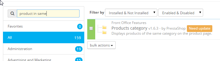

Chris Mok Posted June 11, 2015 Share Posted June 11, 2015 Hi All, in the Modules menu, search "Product in same category" by default this module is not installed, so you need to install it and see the product page. Link to comment Share on other sites More sharing options...
Ben90 Posted June 12, 2015 Share Posted June 12, 2015 (edited) Hi All, 2015-06-11 17_39_33-Modules • PS 1.6.0.14.png in the Modules menu, search "Product in same category" by default this module is not installed, so you need to install it and see the product page. Hi Chris, I reckon all of us know about that. What we are looking for here in this thread is "how we can set how many -products in the same category- shown" on product page Edited June 12, 2015 by Ben90 (see edit history) Link to comment Share on other sites More sharing options...
