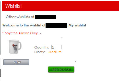

SuperCharlie Posted May 21, 2012 Share Posted May 21, 2012 (edited) I installed PS from my hostgator cpanel and installed the wishlist module from the admin. When someone clicks the link in email to a wishlist, the add to cart button is light green (appears disabled) and does not add to cart. The module is on the right. Ive tried a few things. There are no attributes. I upped the item qty to 100. I tried the forum fix in updating the view.tpl and nothing seems to help. Here is my specs. Server information Prestashop version: 1.4.7.3 Server information: Linux #22 SMP Mon Apr 30 18:59:16 CDT 2012 x86_64 Server software version: Apache PHP version: 5.2.17 MySQL version: 5.5.21-55 Store information Shop URL: http://braydevelopme...ces.com/presta/ Current theme in use: prestashop Mail configuration Mail method: You are using the PHP mail() function. Attached is my entire blockwishlist for your perusal. Any help is appreciated. SC blockwishlist.zip Edited October 11, 2012 by SuperCharlie (see edit history) Link to comment Share on other sites More sharing options...

SuperCharlie Posted October 10, 2012 Author Share Posted October 10, 2012 Ok.. its later. 1.4.8.2 I log in, I add some stuff to my wish list, I send someone the link.. they clicky the link.. and the add to cart is disabled. As attached. The ho ho ho season is coming and I really need to get this going. Any help is appreciated..or even bread crumbs to where it is failing.. Thanks, SC Link to comment Share on other sites More sharing options...

SuperCharlie Posted October 11, 2012 Author Share Posted October 11, 2012 So I found it.. and I will share.. ya no helpin bastages.. The wishlist module assumes you track product quantities. Hard coded for the non-product qty tracking people's enjoyment..like me. In the file modules/wishlist.view.tpl, around line 72 find: {if isset($product.attribute_quantity) AND $product.attribute_quantity >= 1 OR !isset($product.attribute_quantity) AND $product.product_quantity >= 1} change it to {if $product.quantity >= 1} I also removed a few lines to make the grayed out add button and prouct go away if the needed amount was 0 to do this.. remove these two lines completely a little further down.. {else} <span class="exclusive">{l s='Add to cart' mod='blockwishlist'}</span> 1.4.8.2 no product qty tracking Link to comment Share on other sites More sharing options...
