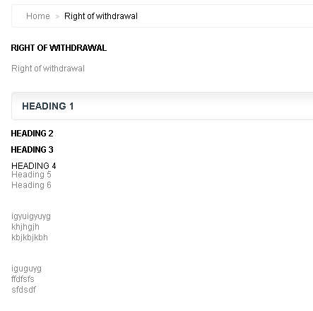

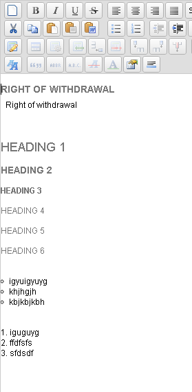

davebox Posted May 17, 2012 Share Posted May 17, 2012 Hello, for some reason I am not able to display any bullet lists or numbered lists. Please refer to the attached snapshots. Headings, bold, italics, strike-through are ok. Quotes does not show either. This has been happening with any theme I've tried so far. Not sure if this is related, but I also noticed that my product "more info" tab is stripping all the CSS related content (e.g. won't even display bold). This was happened only with my current theme, here: http://www.templatem...demo/38591.html I've tried to remove the strip tags instruction in product.tpl for long description with no success...probably I'm not doing this right. Not sure how the two issues play with each other...any thoughts? Thanks! Link to comment Share on other sites More sharing options...
phrasespot Posted May 18, 2012 Share Posted May 18, 2012 So, What You See in WYSIWYG editor Is not What You Get Either theme's or a module's CSS is cascading to style those elements. Try explicitly adding the styling to the element itself in Tiny. E.g. Add 'list-style' rule to your list elements when writing CMS pages and they will be the last rule in cascades therefore not effected by any other rules from other areas. Link to comment Share on other sites More sharing options...
