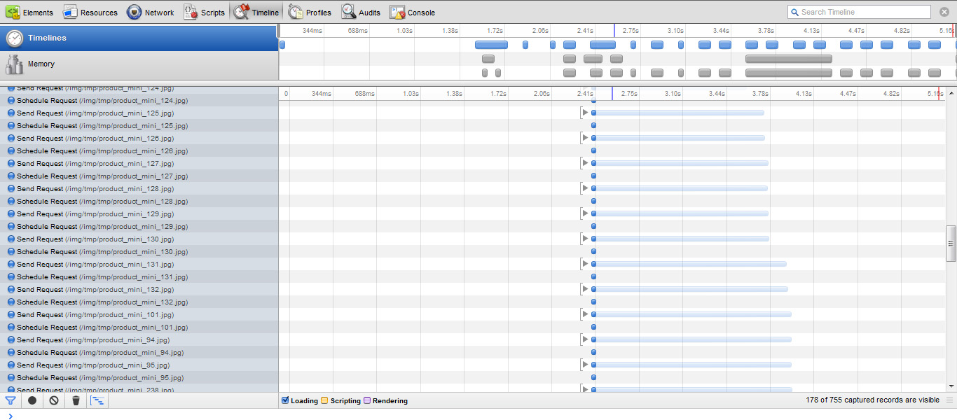

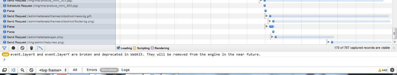

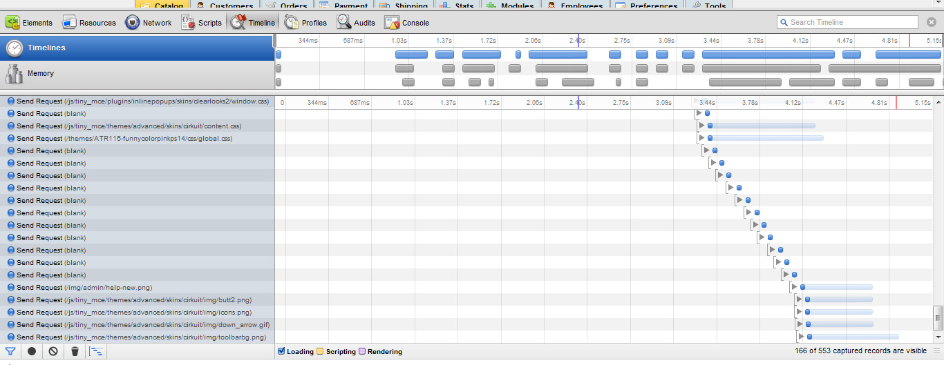

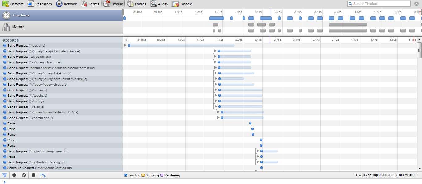

lettersets Posted May 19, 2012 Author Share Posted May 19, 2012 Thanks. I downloaded Google Chrome and did a few recordings with the Developer Tools, which appear to be a very handy resource! I am not quite sure how to read it though. Do I look at just the darker blue or the entire line, including the light blue part? I've included some screen shots, maybe you can have a look? It shows that there are 767 captured records, which seems like a lot. It sometimes gives me the error "event.layerX and event.layerY are broken and deprecated in WebKit. They will be removed from the engine in the near future." But I am not sure what jquery is. Does something jump out at you when you look at it? Michelle Link to comment Share on other sites More sharing options...

phrasespot Posted June 5, 2012 Share Posted June 5, 2012 Does something jump out at you when you look at it? When looking at those screens ignore everything except Send request items. Those tell you when the request was sent with reference to original request and the time it took complete it. You can ignore all error messages. Link to comment Share on other sites More sharing options...
lettersets Posted June 7, 2012 Author Share Posted June 7, 2012 When looking at those screens ignore everything except Send request items. Those tell you when the request was sent with reference to original request and the time it took complete it. I see a bunch of "Send Request (blank)" What does that mean? (see image 4 above) Also, it there a way to see more records in the developer tools? Right now it's only showing the first 150ish records, but I'd like to see them all and can't see to find a way how. Link to comment Share on other sites More sharing options...
