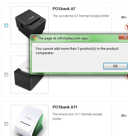

xhaling Posted May 12, 2012 Share Posted May 12, 2012 Hi, When using the 'compare' or 'product comparison' module, I've found that the check boxes don't reset themselves to 'unchecked'. For example: 1. Check 3 products for comparison in category 1 2. Go to a different category 3. Check another product for comparison, but warning message comes up that 'you can't compare more than 3 products'. I'm assuming that simply, the variables haven't been reset, but I can't find out where/how to reset them. Is there a known fix for this? I'm using PS 1.4.7.3 and my site is: www.infinitybas.com Any help would be really appreciated. Thanks. Link to comment Share on other sites More sharing options...
