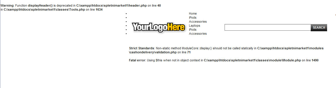

elfstone Posted May 10, 2012 Author Share Posted May 10, 2012 Sorry, but it is not working for me. I installed the last svn which doesn't have COD module and upload the module you paste in previous post. When checkout i received error and the site gets broken. Can you do something about it. I am attaching picture. thank you Link to comment Share on other sites More sharing options...

robbycassa Posted June 13, 2012 Share Posted June 13, 2012 Report a malfunction of the module cashondelivery (1.5 RC): Payment confirmation is not working and displaying only a blank page. More precisely, the execution stops at the point in the file validation.php: echo Module::display('cashondelivery', $ template); To quickly resolve i commented the request for confirmation, is no longer given the opportunity to confirm the payment method but it works. If you have the elegant solution would be grateful 1 Link to comment Share on other sites More sharing options...

wampsi Posted November 7, 2012 Share Posted November 7, 2012 (edited) I have a solution: I downloaded and installed file provided by Mike Kranzler Quote Hi elfstone, This is the very latest version of the COD module on SVN. Go ahead and give it a try! cashondelivery.zip 17.01K 246 downloads I hope this helps. -Mike Then in this file: Modules/CashOnDelivery/validation.php Change this line: echo Module::display('cashondelivery', $ template); To this line: $smarty->display(dirname(__FILE__).'/'.$template); It seems that there is a problem with module class display method. So i simply changed to Smarty way of displaying tpl files. Edited November 7, 2012 by wampsi (see edit history) 1 Link to comment Share on other sites More sharing options...
