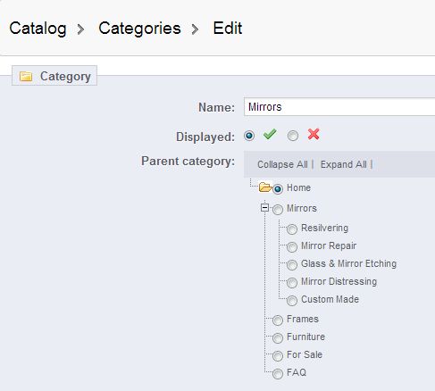

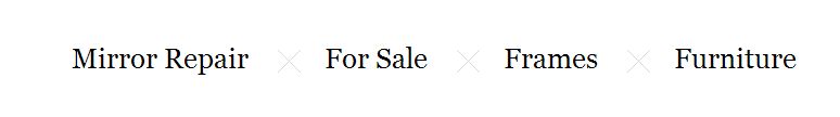

andreafed Posted September 28, 2013 Share Posted September 28, 2013 I'm having exactly the same issue. The categories in the live navigation have no bearing to the way I have them configured under Categories. All my drop down categories are gone in the front end shop. The only thing left is a navigation structure that looks nothing like how I have it set up. After reading a few posts I disabled all but US language, but that did nothing to address the problem. I also would like to know if the number to the left of the Category name (back end) has anything to do with it - and how you can change it if it does. My first Category is numbered 13 to the left of its name in the back end shop. No idea how to change that or whether that's the cause of the problem. I've attached pics of the back end category config and the resulting front end... not even close. Any help with this would be greatly appreciated. Link to comment Share on other sites More sharing options...
stottycabanas Posted September 28, 2013 Share Posted September 28, 2013 Andreafed, in back office go to Modules/Modules, scroll to Top Horizontal Menu and click Configure. Add/Remove categories and links as needed. The entries in the right-hand box determine what displays in your front-end menu. Make sure you get the desired sequence right first time - there's no facility to change the positions in the menu other than remove them and start again. Cheers, Dave 1 Link to comment Share on other sites More sharing options...
andreafed Posted September 30, 2013 Share Posted September 30, 2013 Thanks, Dave... Yes, even TemplateMonster had trouble figuring that out.. we tried clearing the FTP cache, clearing the Smarty Cache, even the browser cache... nothing... and all the time it was just a Module config... Lol ...just another day in Developer World! Link to comment Share on other sites More sharing options...
