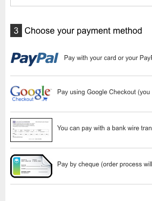

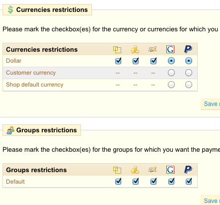

pietro Posted July 1, 2013 Share Posted July 1, 2013 Hi, my authorize AIM module was working great. recently I noticed an unusual amount of paypal transactions and realized that CC payment does not show as an option during checkout. Reading this http://forge.prestashop.com/browse/PNM-1375, I recall that I disabled payment by check. unfortunatelly his solution does not work for me. I uninstall/install the authorize module but it did not work. I disabled all payment options for the country and all of them come back when I re-enable them except for auhorizeAIM. I reinstalled the pay by check module and the check option shows but the authorize module is not there. I have a valid SSL certificate My currency and country are enabled for the module I am running PS 1.4.6.2. Authorize AIM module 1.3 by PS Your prompt assistance will be appreciated since most of my transactions are paid with CC and it is currently unavailable. Thanks in advance, Pietro. Link to comment Share on other sites More sharing options...
pietro Posted July 2, 2013 Share Posted July 2, 2013 Somehow my https got disabled, therefore the AIM module was not working. I noticed after reading this threat. http://forge.prestashop.com/browse/PSCFI-2954 It is all good again. Thanks, Pietro Link to comment Share on other sites More sharing options...
