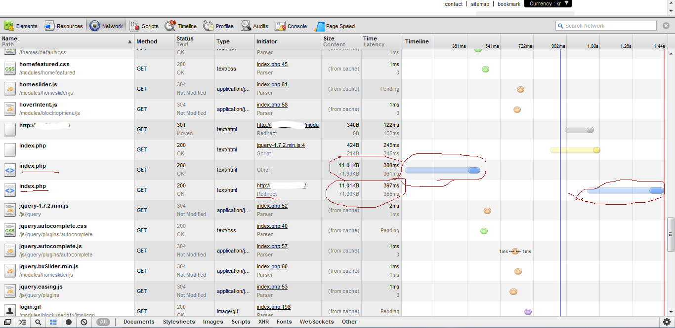

@Trip.. Thanks for this debug option. This is something new for me on PS and never noticed it.
I agree the first byte is 2 sec but only after removing blockspecial module in 1.5.2 installation. If I enables the same module it goes to 5 sec for first byte. In 1.4.7 I have seen the first byte coming within 1.5 sec.
Although this is 500ms loss but looks significant when the server is hosted outside the country in remote location due to additional network delay involved.
For blockspecial module I have posted in multiple threads and also raised a bug but developers are working on more critical issues right now then to work on fixing the speed related issues. The people who are directly impacted are the one`s who have upgraded their DB. Fresh install is still good.
