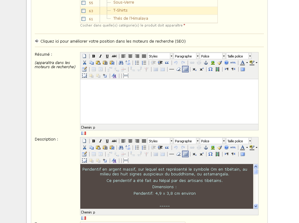

hurray Posted April 8, 2012 Share Posted April 8, 2012 I am using Firefox 11.0 and just recently I am facing with a problem. On the backend of my prestashop, the short-description field of a product has greyed-out. I cannot add, remove or edit anything that is there. I do not even see the text. The main description however is fine. Please take a look at the screenshot. I have not been able to work at all due to this problem. Can some one please help? It works with Internet Explorer though. Thanks. Link to comment Share on other sites More sharing options...

Mike Kranzler Posted April 10, 2012 Share Posted April 10, 2012 Hi Indus, I have the latest version of firefox 11.0 and it is still not working. I do not use other browser besides firefox. Isn't there a solution? Hi hurray, The bug is with Firefox 11 and compatibility with TinyMCE. Our developers have already pushed out a fix, so you should check out version 1.4.7.3, as indus posted above. This was a change in Firefox that our team had no way of predicting until it is released, but we pushed out a fix as soon as we were made aware of the change. I hope this helps. -Mike Link to comment Share on other sites More sharing options...

Mike Kranzler Posted April 10, 2012 Share Posted April 10, 2012 Hi Indus and Mike, Thanks for your help. Since my site has had a lot of template modifications, I cannot use newer version of prestashop. I guess I will either revert back to old version of firefox or use IE or some other browser. At the same time does it mean that one day it might now work even in IE and other browsers? Hi hurray, You can try updating TinyMCE as well. You can find a discussion on this issue here. -Mike Link to comment Share on other sites More sharing options...
