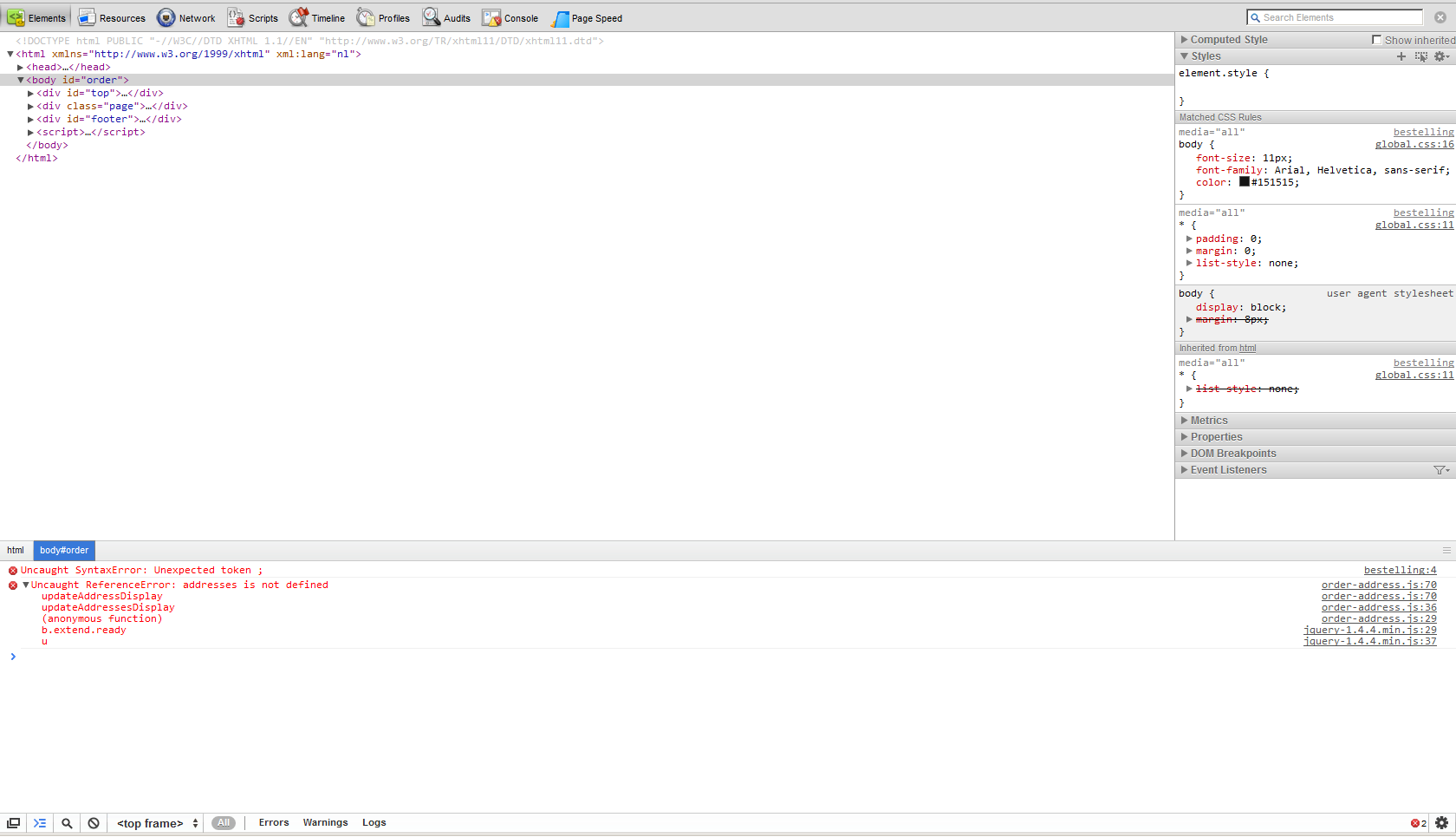

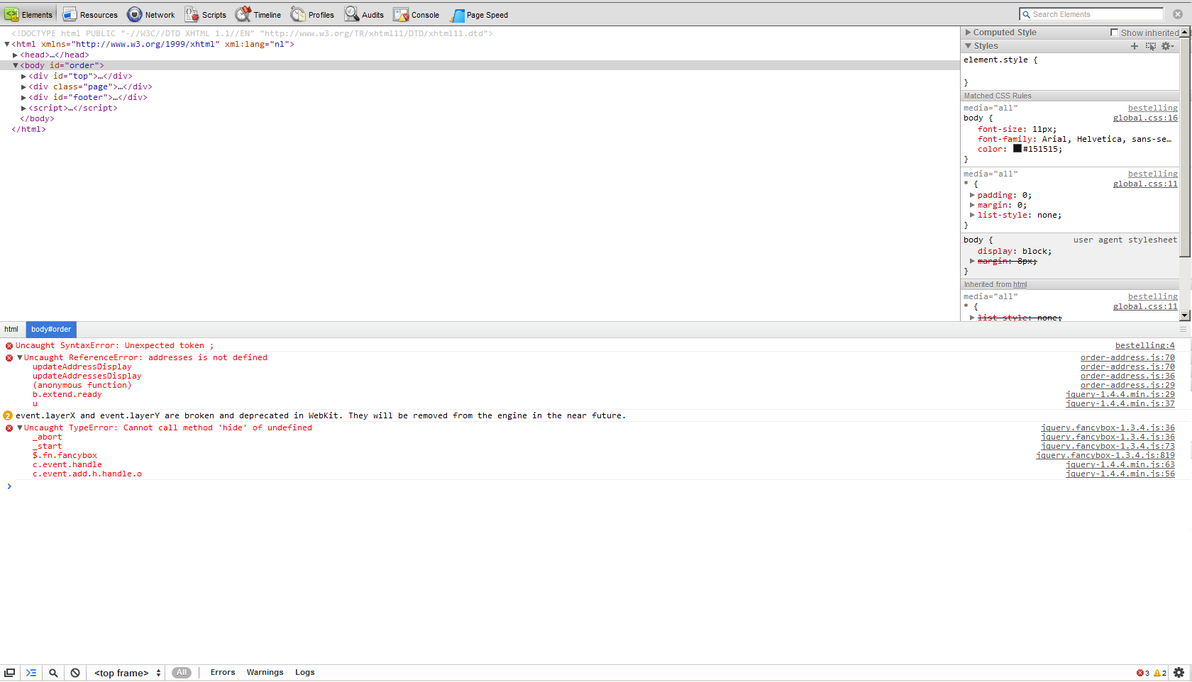

Frank van der Voort Posted April 3, 2012 Share Posted April 3, 2012 Hi all, I have a bit of a problem with the (read) link when accepting the terms & conditions. When I click on it it does not open. When using the inspection tools it gives a error when i'm on the order carrier page (see picture 1) after clicking on the (read) link it gives a extra error (see picture 2). Probably the javascript pop up is broken because when i open it in a new tab the link still works. I really don't know how to fix this problem. Last week the link still worked but know it is broken. Does somebody know how to fix this problem? Link to comment Share on other sites More sharing options...

hristianita Posted June 11, 2012 Share Posted June 11, 2012 Hello, I found a solution for my problem. In the file order-address.js located in the js folder of my theme, I changed $(document).ready(function() { updateAddressesDisplay(true); }); to $(document).ready(function() { if (typeof(addresses)!='undefined') updateAddressesDisplay(true); }); That solved it for me. Hope it works for you too. 1 Link to comment Share on other sites More sharing options...
