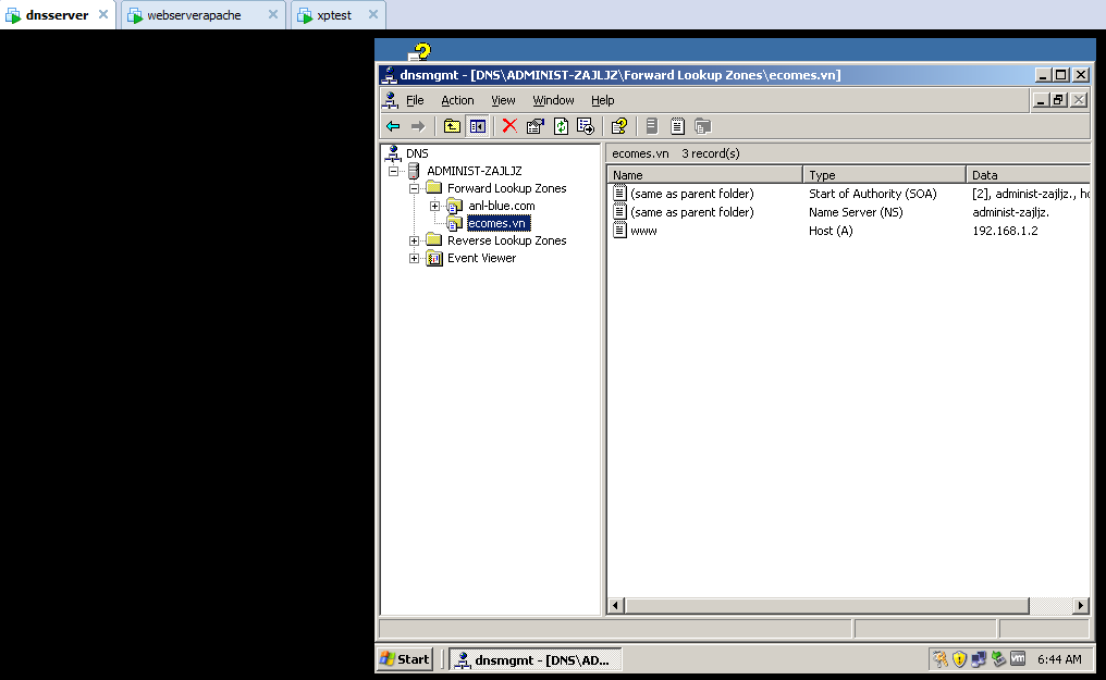

kimcuongden1712 Posted March 28, 2012 Share Posted March 28, 2012 i have 1 dns server(192.168.1.1): zone name ecomes.vn 1 webserver(192.168.1.2) install prestashop 1 xp test (192.168.1.3) run chorme browse when open chorme browse(XP) and type : 192.168.1.2/ecom then "pape not pound" ( ecom: name file setup prestashop in XAMPP can u help my problem? my english is bad ( thank for all!!! Link to comment Share on other sites More sharing options...

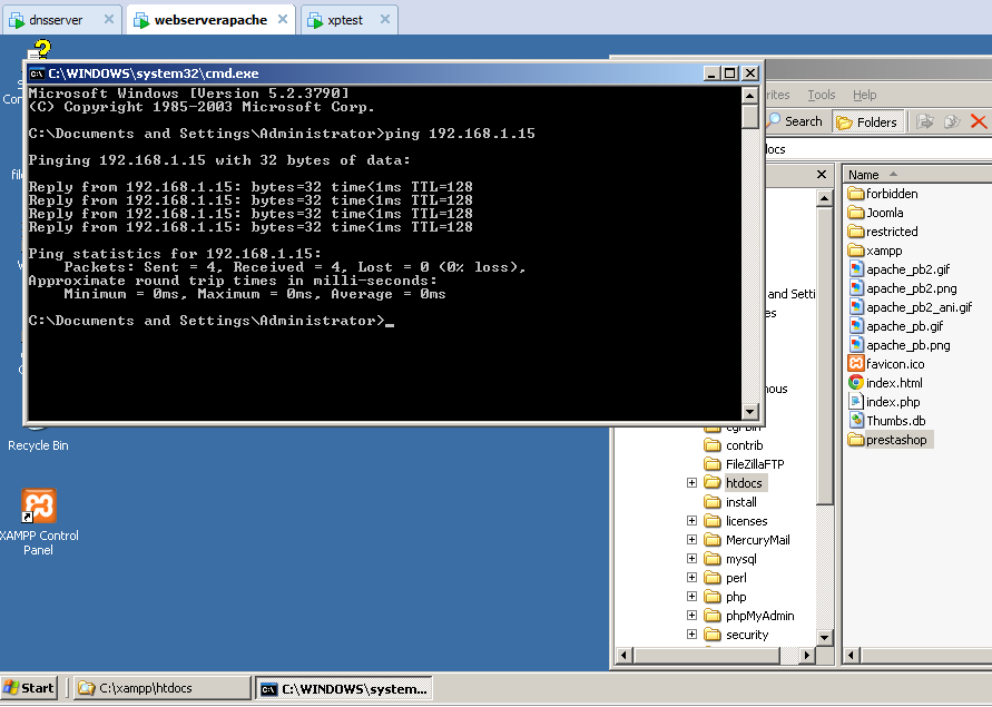

kimcuongden1712 Posted March 30, 2012 Author Share Posted March 30, 2012 have a problem! when type 192.168.1.15/prestashop(prestashop : forder setup prestashop opensouce) in xp test then address 192.168.1.15/prestashop =>> localhost/prestashop? i think my problem, how fix problem? Link to comment Share on other sites More sharing options...
nextp Posted March 31, 2012 Share Posted March 31, 2012 Now you describe your problem correctly - i understand that you have created three virtual machines in vmware. Are all of them in the same virtual network VMNET2? Can you ping each other? In the last answer you make me think that there are duplicate ip addresses. Check the ip addresses of all machines - reconfigure if needed - ping each other and retest- it should work. Link to comment Share on other sites More sharing options...
kimcuongden1712 Posted March 31, 2012 Author Share Posted March 31, 2012 Now you describe your problem correctly - i understand that you have created three virtual machines in vmware. Are all of them in the same virtual network VMNET2? Can you ping each other? In the last answer you make me think that there are duplicate ip addresses. Check the ip addresses of all machines - reconfigure if needed - ping each other and retest- it should work. yes all i ping readly, i fix is in preferences/ssl and add ip wenserver now, i have problem is vitual host! and ssl certificate?? U can help? thank all Link to comment Share on other sites More sharing options...
