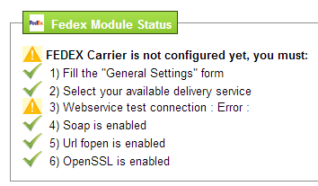

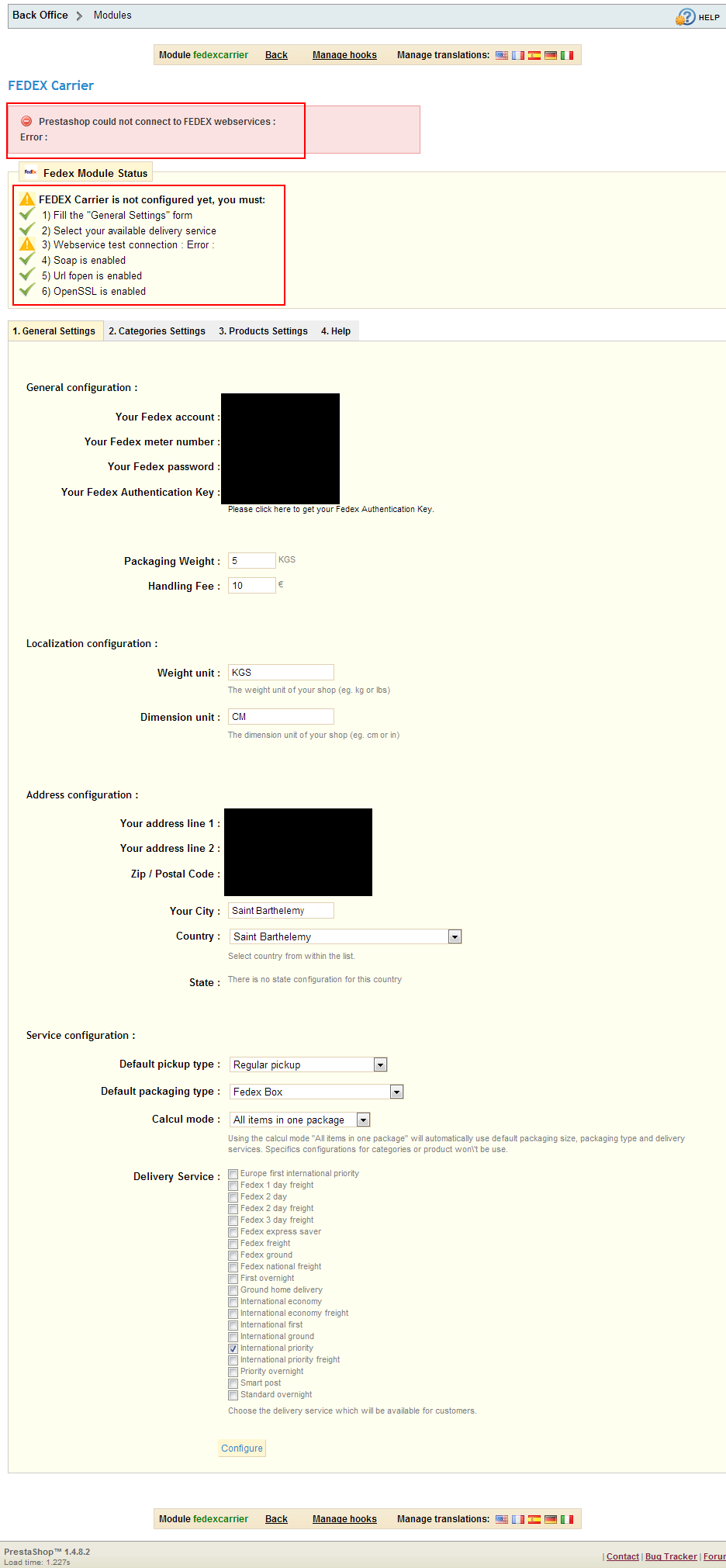

leooxx Posted December 30, 2012 Share Posted December 30, 2012 Hello, I have the same problem. I'm using the Fedex module 1.2.6 with Prestashop 1.4.8.2. I have added all production parameters from Fedex. If i'm changing one parameter, he say "Error 1000 : authentification failed". I think all informations and the authentication are good. Soap, Url & OpenSSl are enabled... FEDEX Carrier is not configured yet, you must: 1) Fill the "General Settings" form 2) Select your available delivery service 3) Webservice test connection : Error : 4) Soap is enabled 5) Url fopen is enabled 6) OpenSSL is enabled But the module throw an error without code or description : Prestashop could not connect to FEDEX webservices : Error : Can anyone help me? How to get more logs or error details? I have downloaded the last Prestashop 1.5 and looking for this module on Prestashop Addons website but this module is now missing. Do you know if the Fedex Module is stopped? Thanks 2 Link to comment Share on other sites More sharing options...
