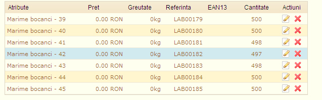

webbusiness23 Posted February 12, 2012 Author Share Posted February 12, 2012 I have attached a few images that will explain in detail my issue. I have a single product, with more combinations (the boots have different sizes, from 39 to 45). Each size has a different code assigned. The default code for the boots it LAB00179. When i search for LAB00179 the boots are returned as a result. But when i search for LAB00181 i get no result at all. What i need is to get results after i search for codes such as LAB00181. How can i accomplish that? --> this is the default size of the product --> these are the product's combinations --> this is a random size of the product, which needs to be returned as a result after searching for the assigned code. Link to comment Share on other sites More sharing options...
phrasespot Posted February 12, 2012 Share Posted February 12, 2012 Hmm... you are right, there is a bug. References assigned to combinations are not indexed but instead the reference entered in the info tab is indexed for combinations too. First file a bug report. You can simply point to this forum thread in bug description. Bug info: ----------- Reference assigned in info tab of a product References assigned to combinations Indexed result ------------ Meanwhile, you can use this bug for your purposes. Here is what you can do. For the main product specify a reference like LAB00197 - 00 (or more digits if you have more than 99 combinations). Then for each combination assign a reference by increasing the last two digits by one. LAB00197 - 01, LAB00197 - 02 etc. Now because of the (buggy) way references are indexed, when you search for LAB00197 - 05 (or just LAB00197) you will have a hit on LAB00197 - 00. screen capture screen capture screen capture screen capture screen capture Link to comment Share on other sites More sharing options...
