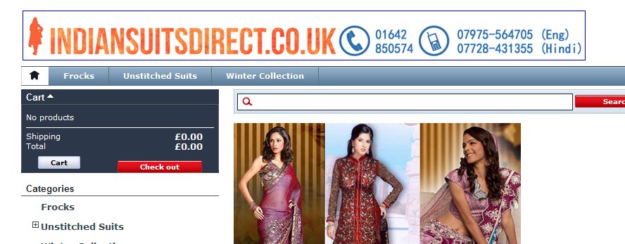

Mehdi72 Posted February 4, 2012 Share Posted February 4, 2012 I am using the prestastore_alt theme and there is nothing in the header.tpl file relating to the logo and I can't figure out which part of the global.css file sets the margin or padding. I want to align my logo with the homepage icon. Any ideas? This is the store : http://indiansuitsdirect.co.uk/store/ Link to comment Share on other sites More sharing options...
tdr170 Posted February 4, 2012 Share Posted February 4, 2012 This will be in global.css look for IMG.logo and add this line margin-right: 12.5em; its not to far down from the top. should look like this when done. img.logo { float: left; font-size: 2em: font-weight: bold: margin-right: 12.5em } If you do this right your page will look like this. Link to comment Share on other sites More sharing options...
CraigMeade Posted February 4, 2012 Share Posted February 4, 2012 I did this my modifying the logo itself. Creating the right amount of padding in the image. But the code solution looks good too. Link to comment Share on other sites More sharing options...
Mehdi72 Posted February 4, 2012 Author Share Posted February 4, 2012 This will be in global.css look for IMG.logo and add this line margin-right: 12.5em; its not to far down from the top. should look like this when done. img.logo { float: left; font-size: 2em: font-weight: bold: margin-right: 12.5em } If you do this right your page will look like this. Thanks. That didn't work but I uploaded the logo under Homepage logo then it aligned correctly. I couldn't remove the Homepage ad logo so replaced it with a dummy image (1 px x 1 px). Is there a way to remove the logo in css without using a dummy image? The other things I want to customise is the colour of the search button and checkout buttons. I want to use an orange gradient but can't figure out which part of the global.css to edit. It looks like the buttons use the button-medium_exclusive.gif but I replaced that and it didn't change the colour. Why is it the simplest things are the most difficult to change!?!?!? Link to comment Share on other sites More sharing options...
tdr170 Posted February 4, 2012 Share Posted February 4, 2012 That absolutly should have worked you probably did not re-compile your page after making the change to your global.css. (force compile under preferences/ performance) The pic is your site with the margin line added using my developer tool, but glad you got it to work anyway. When you make a change you must force compile what you are seeing is the cached version of your page. Link to comment Share on other sites More sharing options...

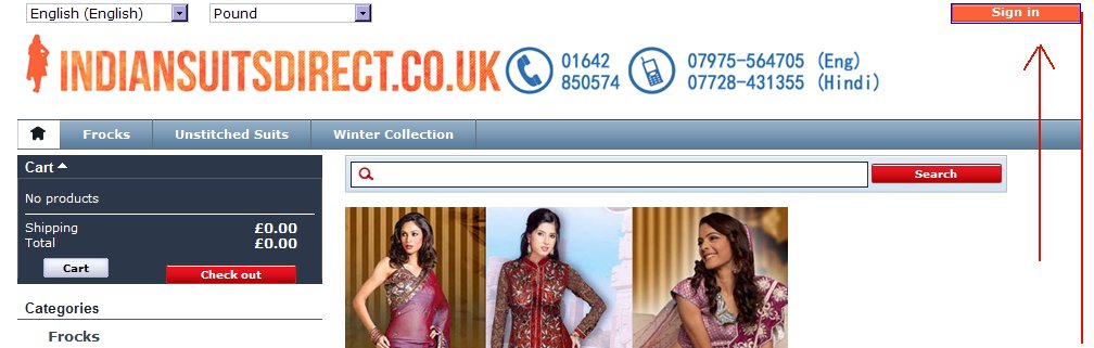

tdr170 Posted February 4, 2012 Share Posted February 4, 2012 The blue navigation bar is correct the sign in and search bar are not aligned to the right side of your page. I confirmed this with my developer tool, the Nav bar is 980px wide, that is the default page size for Prestashop. Locate .v2 signin in your global.css and you will see that the Sign In button has a 75px right margin I changed to 0px and here is what the page looks like. I am sure it is the other elements that are not correct not the Nav bar. Link to comment Share on other sites More sharing options...
Mehdi72 Posted February 5, 2012 Author Share Posted February 5, 2012 I added the right padding myself in order to align the sign in button with the search button. I wanted the nav bar to align with the sign-in and search buttons not the other way round. Oh well. Link to comment Share on other sites More sharing options...
tdr170 Posted February 5, 2012 Share Posted February 5, 2012 I would move the search button to the right and then remove the padding from the sign in button otherwise you will have other problems in the future. Sorry but you are thinking in reverse. Link to comment Share on other sites More sharing options...

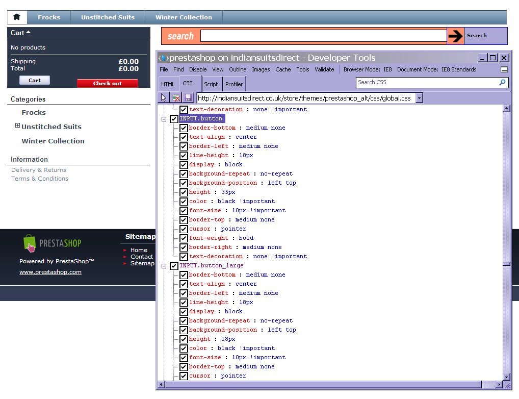

tdr170 Posted February 8, 2012 Share Posted February 8, 2012 What I would do is make the search button the same height as the search bar, then change the width so it could have a centered look to the right of the search bar. This would allow larger font size to match the font in the sign in button. You could remove the icon of the magnify. glass look in blocksearch.css (themes/prestashop/css/modules/blocksearch) Also you can make your entire seach bar to 680 it is overhanging to the right probably cut off, it will not effect what you see, try it. when I click on it with my tool there is a box that highlights what I am viewing that box over hangs to the right. Overall the sight is looking good, glad to see you moved things right, I looked at some products and noticed had you moved the nav bar to the left then your products would be overhanging to the right. Link to comment Share on other sites More sharing options...

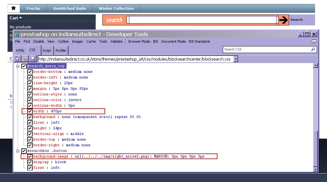

Mehdi72 Posted February 8, 2012 Author Share Posted February 8, 2012 This adjusts cursor position in search bar : #search_query_top {background:transparent;/*border:1px solid red;*/border:none;outline:0;width:520px;height:24px;line-height:20px;vertical-align:middle;margin:5px 0 0 90px;float:left} I have designed a new search bar. I want to use an arrow instead of the search button but the text link (for search.php) and mouse over are still active so it doesn't display correctly and I can't move it back on the same line as the search bar. How do I hide the text link behind the button? I have attached the arrow so you can see what it's supposed to look like. http://indiansuitsdirect.co.uk/store/ Link to comment Share on other sites More sharing options...
tdr170 Posted February 8, 2012 Share Posted February 8, 2012 Well I was able to get it in the position you want but I could not move the actual search bar to the right. Maybe you can look at the pics and get an idea how to do it. I am someone limited by not being able to edit the actual files. But I did notice that in your global.css the button height is only 18 needs to be 35 (first pic). Hope this helps. Link to comment Share on other sites More sharing options...
Mehdi72 Posted February 8, 2012 Author Share Posted February 8, 2012 I want the arrow positioned to the right of the search bar. If I adjust the margin over 130px the arrow drops to the next line. Also you'll notice increasing the height to 35px : span.exclusive_mini, span.exclusive_small, span.exclusive, span.exclusive_large, span.exclusive_large_disabled { background-repeat: no-repeat; background-position: top left; border: none; color: black!important; font-weight: bold; font-size: 10px!important; text-align: center; text-decoration: none!important; cursor: pointer; display: block; line-height: 18px; height: 35px Also increases the height of the cart and checkout buttons. Any idea how to hide the text link for search? Link to comment Share on other sites More sharing options...

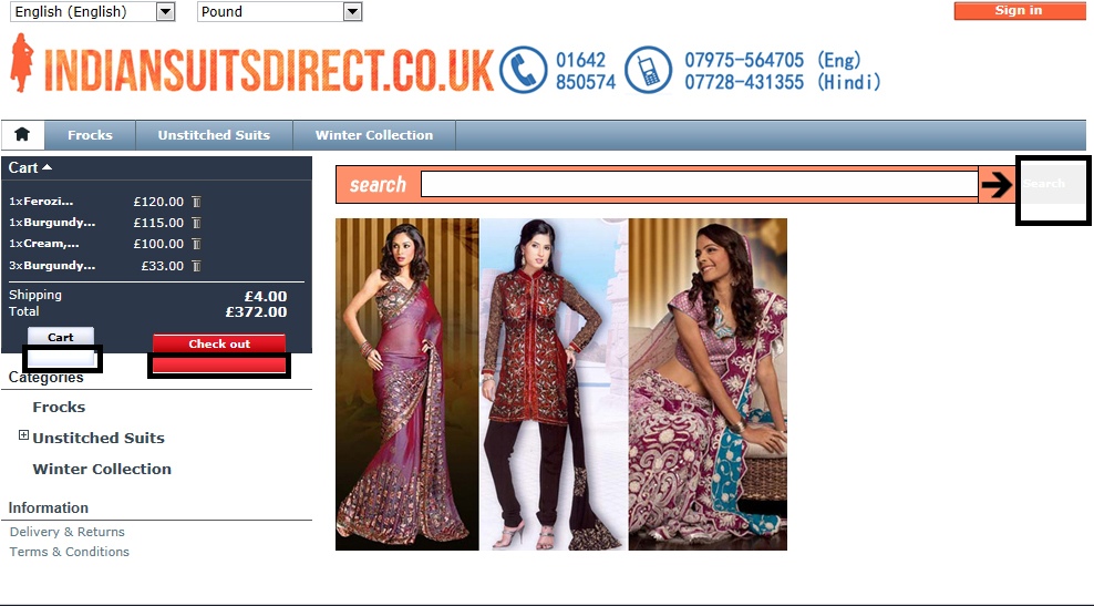

tdr170 Posted February 8, 2012 Share Posted February 8, 2012 If yo are talking about the white letters SEARCH on the right, that is actually part of the v2-searchbar3.png file. Find that image in your image folder and download to your computer, use a paintshop program to color over it. OH what the hell here it is. Just upload this where ever the original is located overwriting it and search will be gone. This one I moved the search area left and corrected size to 680. You will have to move your actual search area left to line up. Things I noticed your actual search area does not line up top to bottom with the white area change this : #search_query_top margin 5px 0 0 108px (this also moves the search button left so it is not cut off) Also change: #searchbox_button margin 0 0 0 Link to comment Share on other sites More sharing options...
Mehdi72 Posted February 8, 2012 Author Share Posted February 8, 2012 If yo are talking about the white letters SEARCH on the right, that is actually part of the v2-searchbar3.png file. Find that image in your image folder and download to your computer, use a paintshop program to color over it. OH what the hell here it is. Just upload this where ever the original is located overwriting it and search will be gone. The text is not part of the png. I have attached my png. This one I moved the search area left and corrected size to 680. You will have to move your actual search area left to line up. Things I noticed your actual search area does not line up top to bottom with the white area change this : #search_query_top margin 5px 0 0 108px (this also moves the search button left so it is not cut off) Also change: #searchbox_button margin 0 0 0 That didn't really work. I've removed several lines of code. What you will see now is the right arrow with the word search bleeding into it. Although the hover is gone I still can't get rid of the text. I think I need to change the value here : <!DOCTYPE html PUBLIC "-//W3C//DTD XHTML 1.1//EN" "http://www.w3.org/TR/xhtml11/DTD/xhtml11.dtd"> <html xml:lang="en" xmlns="http://www.w3.org/1999/xhtml"> <head> <body id="index"> <div id="page"> <div id="header"> <div id="columns"> <div id="left_column" class="column"> <div id="center_column"> <form id="searchbox" action="http://indiansuitsdirect.co.uk/store/search.php" method="get"> <div> <input type="hidden" value="position" name="orderby"> <input type="hidden" value="desc" name="orderway"> <input id="search_query_top" class="search_query ac_input" type="text" value="" name="search_query" autocomplete="off"> [i]<input class="button" type="submit" value="Search" name="submit_search">[/i] </div> </form> <div class="clear"> </div> <script type="text/javascript"> <img width="408" height="300" alt="" src="/store/modules/blockadhome/Splash3.jpg"> <div class="clear"> </div> </div> <div id="right_column" class="column"> </div> </div> <div class="flatclear"> </div> </div> <div id="v2-footer"> <div class="ac_results" style="display: none; position: absolute; width: 500px; top: 169px; left: 453.4px;"> </body> </html> To : <input class="button" type="submit" value="" name="submit_search"> I think this is where the text that is bleeding over the image comes from but I don't know which page I need to edit. I've looked in index.php and header.tpl. Link to comment Share on other sites More sharing options...
tdr170 Posted February 9, 2012 Share Posted February 9, 2012 ooops im sorry I meant to say left. (white search) Not sure what you did but now I cant access certain files and elements are missing from blocksearch .css. #search_query_top margin 5px 0 0 108px is completely gone??? Link to comment Share on other sites More sharing options...

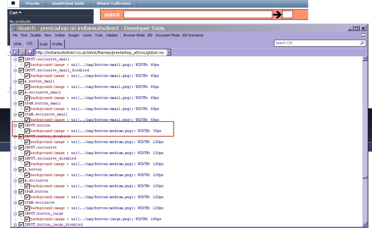

tdr170 Posted February 9, 2012 Share Posted February 9, 2012 The button is still only 18px high you must not be changing the right one or in the right place. If I change to 35 it looks good with the exeption of the white bar running into it. Notice this change did not effect the cart button. When this is fixed if you relpace the background image with the one below and you will have a margined search button. Should look like this when done. Link to comment Share on other sites More sharing options...
Mehdi72 Posted February 9, 2012 Author Share Posted February 9, 2012 The button is still only 18px high you must not be changing the right one or in the right place. If I change to 35 it looks good with the exeption of the white bar running into it. Notice this change did not effect the cart button. I'll take another look. When this is fixed if you relpace the background image with the one below and you will have a margined search button. Should look like this when done. I don't want the search text! I just want the arrow. There has to be a way to get rid of that text. This is what the search bar should look like. It's important I learn how to do this because I want to replace the cart and check out buttons and I will have the same problems, as I had with the sign in button which isn't a button but in fact a coloured gradient button with the sign in link text aligned over it. I couldn't find a way to remove the text link. Same issue with the arrow, even though I have replaced the default image the damn text link is still there and I can't figure out how to get rid of it. I want the images to link to the url or relevant php file, I don't want to position a text link near or over an image. Link to comment Share on other sites More sharing options...
tdr170 Posted February 9, 2012 Share Posted February 9, 2012 OHHHHH oh find search.php and change this: <input name="submit_search" class="button" type="submit" value="Search"/> to this: <input name="submit_search" class="button" type="submit" value=""/> Link to comment Share on other sites More sharing options...

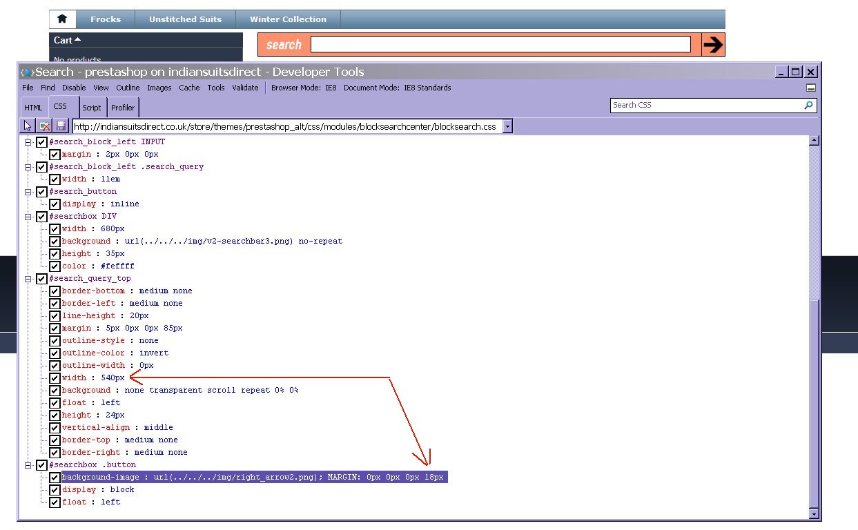

tdr170 Posted February 9, 2012 Share Posted February 9, 2012 OK found it in mine I can change the search to find or I can remove it, mine was in ../modules/blocksearch/blocksearch-top.tpl I changed this <input type="submit" name="submit_search" value="{l s='Search' mod='blocksearch'}" class="button" /> to this <input type="submit" name="submit_search" value="{l s='Find' mod='blocksearch'}" class="button" /> and my search button then said Find. Link to comment Share on other sites More sharing options...
Mehdi72 Posted February 9, 2012 Author Share Posted February 9, 2012 I think you meant height not width : background-image: url('../img/button-medium.png');height:35px I have made the changes, the search text and the on hover are still there. My blocksearch-top.tpl (/store/modules/blocksearch) reads : <form method="get" action="{$link->getPageLink('search.php')}" id="searchbox"> <p> <label for="search_query_top"><!-- image on background --></label> <input type="hidden" name="orderby" value="position" /> <input type="hidden" name="orderway" value="desc" /> <input class="search_query" type="text" id="search_query_top" name="search_query" value="{if isset($smarty.get.search_query)}{$smarty.get.search_query|htmlentities:$ENT_QUOTES:'utf-8'|stripslashes}{/if}" /> <input type="submit" name="submit_search" value="{l s='' mod='blocksearch'}" class="button" /> <!--<input type="submit" name="submit_search" value="{l s='Search' mod='blocksearch'}" class="button" /> --> </p> </form> The changes I make here aren't showing up : <input type="submit" name="submit_search" value="{l s='' mod='blocksearch'}" class="button" /> Link to comment Share on other sites More sharing options...
tdr170 Posted February 9, 2012 Share Posted February 9, 2012 No look at the pic again it is width that takes the part with search and shrinks it to the same size as the arrow. I will look to see if you have removed the right Search as that worked for me. After making that change to the tpl file did you go to back office and turn on force complile and turn cache to off. Link to comment Share on other sites More sharing options...

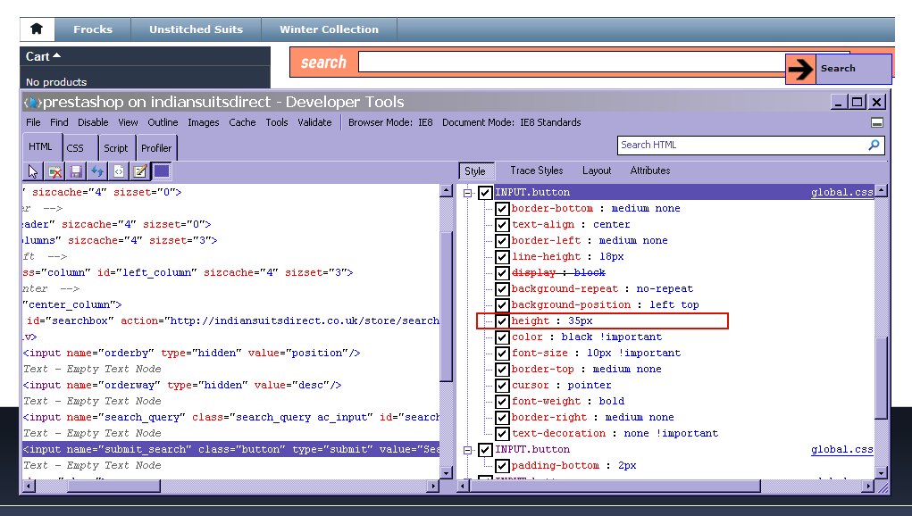

tdr170 Posted February 9, 2012 Share Posted February 9, 2012 This is what worked for me in order to see the changes I had to turn thr force compile to ON and click the link to the shop on top left of BO. <form method="get" action="{$link->getPageLink('search.php')}" id="searchbox"> <p> <label for="search_query_top"><!-- image on background --></label> <input type="hidden" name="orderby" value="position" /> <input type="hidden" name="orderway" value="desc" /> <input class="search_query" type="text" id="search_query_top" name="search_query" value="{if isset($smarty.get.search_query)}{$smarty.get.search_query|htmlentities:$ENT_QUOTES:'utf-8'|stripslashes}{/if}" /> <input type="submit" name="submit_search" value="{l s='' mod='blocksearch'}" class="button" /> </p> </form> Link to comment Share on other sites More sharing options...
tdr170 Posted February 9, 2012 Share Posted February 9, 2012 Also note that when I look at your shop with my tool the Search is still showing up in that line???? Link to comment Share on other sites More sharing options...

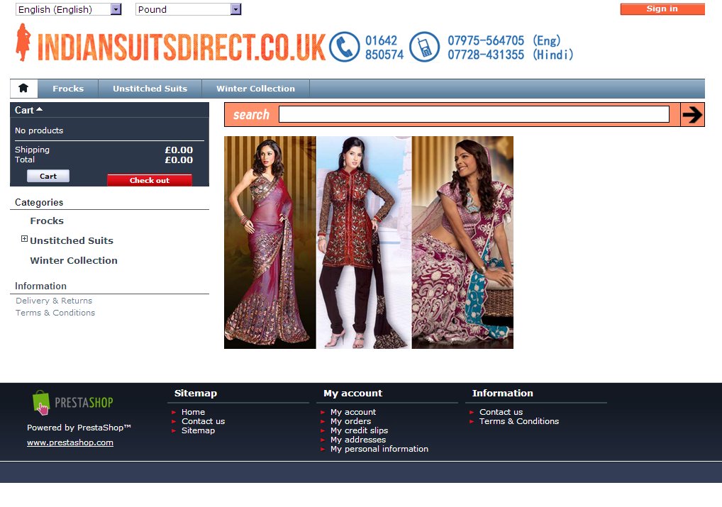

tdr170 Posted February 9, 2012 Share Posted February 9, 2012 Done, Fixed, Finished, Complete have a look. added some code to blocksearch.css and found that you have blocksearchcenter that contained the tpl file with the search text in it. modules/blocksearchcenter/blocksearchcenter.tpl #searchbox .button{height:35px; width:35px; background-image: url('../../../img/right_arrow2.png'); margin: 0px 0px 0px 18px;display:block;float:left} Link to comment Share on other sites More sharing options...
Mehdi72 Posted February 9, 2012 Author Share Posted February 9, 2012 Unbelievable two lines of code was causing all this. Thanks but hold you horses! Almost done. If you hover over the arrow it shrinks so there appears to be a on mouse over effect? Link to comment Share on other sites More sharing options...
tdr170 Posted February 9, 2012 Share Posted February 9, 2012 Yes I saw that thought thats the way you had it. Do you want that gone. Link to comment Share on other sites More sharing options...
Mehdi72 Posted February 9, 2012 Author Share Posted February 9, 2012 Yes I saw that thought thats the way you had it. Do you want that gone. Yes! Link to comment Share on other sites More sharing options...
tdr170 Posted February 9, 2012 Share Posted February 9, 2012 What do you want it to do have a look I took the mouse over effect off and changed the mouse over color of text. OOOps I tought you wanted it gone I will wait to hear from you. Link to comment Share on other sites More sharing options...
