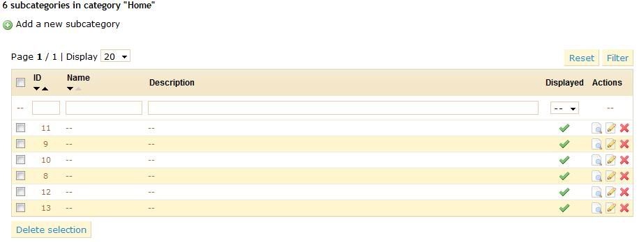

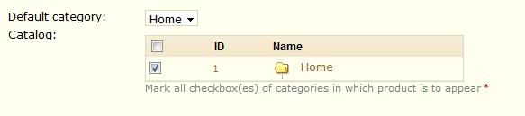

Mredin Posted March 20, 2009 Share Posted March 20, 2009 Hi everyone..I have a little problem..When i make a new catagory, there is no name of the catagorys... Look at this picture:And that is a problem when i want to creat a new product, because there is no catagorys..Look at this picture:What shall i do??Please help me I have the 1.0 version. with danish lang. Link to comment Share on other sites More sharing options...

Mredin Posted March 20, 2009 Author Share Posted March 20, 2009 Ok - i found the problem now.. If anybody have the same problem as mine then the problem is:If you ONLY choose: Danish, as a possible lang. at your site - the adminpanel will not work... Make English possible as well, and then the problem is gone Link to comment Share on other sites More sharing options...
