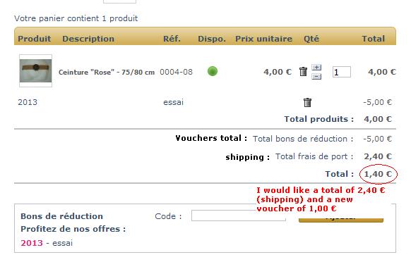

kant74 Posted January 21, 2012 Share Posted January 21, 2012 Hi, I need to create vouchers with options "reduction on the order (amount)" and "create a new voucher with remaing amount" for some clients (PS 1.4.6.2). I did a test but there is a problem. When the product is cheaper than the voucher, the remaing amount is deducted of the shipping cost (see screen capture). I really need to change that and i would like that the reduction be only made on the total of products and not on the total order with shipping fees. I think that the calculation are in the classes/cart.php or discount.php but i don't know what i should change to make this work correctly. Is there some codes to add or to remove ? Can someone help me ? It's very important. Thanks. Link to comment Share on other sites More sharing options...

kant74 Posted January 22, 2012 Author Share Posted January 22, 2012 Thanks for your help Richard. At line 948, there is : { $order_total -= Tools::ps_round((float)($discount->getValue(sizeof($discounts), $order_total_products, $shipping_fees, $this->id, (int)($withTaxes))), 2); if ($discount->id_discount_type == 2) if (in_array($discount->behavior_not_exhausted, array(1,2))) $shrunk = true; } I changed $order_total -= Tools::ps... to $order_total_products -= Tools::ps... but when I test, the line "total vouchers" desappear and the voucher of 5 € isn't taken any more into account. It will be more difficult than i thought... Link to comment Share on other sites More sharing options...
