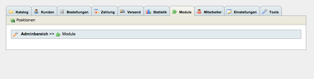

KMTegernsee Posted January 20, 2012 Share Posted January 20, 2012 Hello, I'm a huge mistake in my Prestashop and that if I click on modules in the backend just a white page comes ... and if I want to click on a product in the shop is only a white page. The shop looks so normal but not from when I click on the product ... I am using Prestashop Version 1.3.1.1 version and I have no idea where the fault may lie. Why could this be? Link to comment Share on other sites More sharing options...

tomerg3 Posted January 21, 2012 Share Posted January 21, 2012 It could be a module that is suppressed the error, or your host is not accepting the error reporting. You can try the main error log of the server (usually accessible from cpanel), but if the error is suppressed, it will not show up. Did you add any new modules recently? If so, move them to another folder (one by one), and reload the modules tab. If you did not add any modules, start moving all of them until you find the one that was causing the white screen. Link to comment Share on other sites More sharing options...
