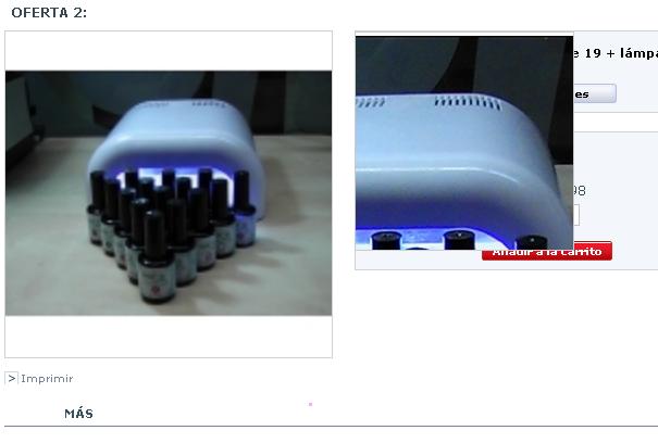

esmalgel Posted January 11, 2012 Share Posted January 11, 2012 The images shown on details of the products occupy a box of 300x300 pixels (as in the attached image). Someone can tell me how to resize the image. I looked any .js but not found how to do that. Thanks! Link to comment Share on other sites More sharing options...
Snade Posted January 12, 2012 Share Posted January 12, 2012 Hi to resize that box, you need to edit products.js (themes/yourtheme/js/products.js) find that part and edit it as you wish : //set jqZoom parameters if needed if (typeof(jqZoomEnabled) != 'undefined' && jqZoomEnabled) { $('img.jqzoom').jqueryzoom({ xzoom: 350, //zooming div default width(default width value is 200) yzoom: 350, //zooming div default width(default height value is 200) offset: 21 //zooming div default offset(default offset value is 10) //position: "right" //zooming div position(default position value is "right") Let me know if this solves it for you. If it does, dont forget to add [solved] in the topic name, and also it will be good if you rename the topic to "jqzoom box resize" or something like that, so other people can find the solution easily. I'll be happy if you "like" my post, if it was helpfull to you. Thanks ! p.s If youre not asking about the size of jqzoom box, but the actuall product image, you can edit the image sizes in backoffice Preferences->Image Cheers 1 Link to comment Share on other sites More sharing options...

Dan1 Posted October 14, 2012 Share Posted October 14, 2012 I changed the box size by editing yourtheme/css/product.css file. Find the 300 in the code and change it to whatever you want, or I should say to match your size setting in BO image preferences. You need to change it twice; for the image and the frame. The images shown on details of the products occupy a box of 300x300 pixels (as in the attached image). Someone can tell me how to resize the image. I looked any .js but not found how to do that. Thanks! Link to comment Share on other sites More sharing options...
