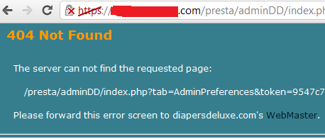

SirNewbie Posted January 5, 2012 Share Posted January 5, 2012 Greetings, I am trying to set up SSL encryption with a shared certificate from my web host. I have successfully obtained the certificate, but am having trouble enabling the SSL encryption from the presta back end. So first I go to SEO & URLs, and set both my Shop domain name and Shop domain name for SSL to the same thing: mysite.com Next I go to Preferences tab and click "Please click here to enable HTTPS protocol before enabling SSL". After clicking that, I get a 404 page not found error. Anyone know what is going on, or what I should do next? Thanks! Link to comment Share on other sites More sharing options...

SirNewbie Posted January 5, 2012 Author Share Posted January 5, 2012 Thanks. I follow these steps and still get the 404 error. In my case, there is no difference between the non SSL URL and the SSL URL from the webhost. Both are myshop.com. However, my shop is running at myshop.com/presta and the SSL certificate is for myshop.com. Maybe there is a problem with having the shop in the .../presta folder. Maybe I'll try removing the /presta subfolder? Link to comment Share on other sites More sharing options...

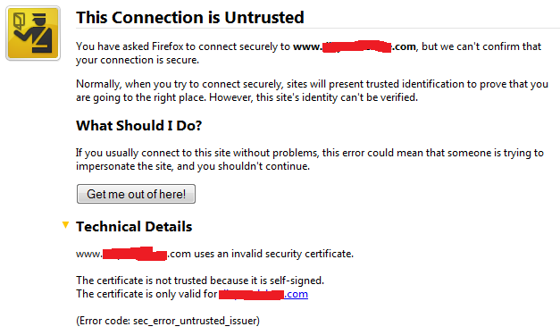

SirNewbie Posted January 6, 2012 Author Share Posted January 6, 2012 Ok, original problem is fixed. I had to purchase a static IP from the webhost to enable the SSL. I now have the SSL enabled for my site, but when the site tries to go to a secure connection, I get an untrusted error from the browser: I am using a shared key from the web host. Is the only way to get rid of the trust error to buy a unique SSL key? Thanks. Link to comment Share on other sites More sharing options...
SirNewbie Posted January 6, 2012 Author Share Posted January 6, 2012 [solved] - my issues were: -needed to purchase a dedicated IP address from the web host. This ended the 404 errors. -needed to purchase a unique SSL certificate. This ended the untrusted errors from the browsers when making a secure connection. Anyone know how to mark the topic as solved? Thanks. Link to comment Share on other sites More sharing options...
