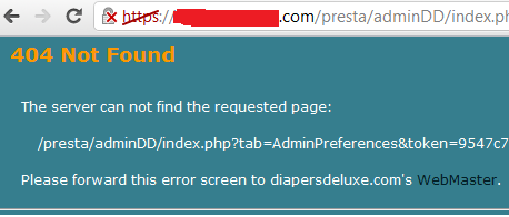

SirNewbie Posted January 5, 2012 Author Share Posted January 5, 2012 ok so when i input my domain name in SEO & URLs, then click enable SSL, i get a 404 page not found error. maybe there is a problem with the ssl certificate? Link to comment Share on other sites More sharing options...
tdr170 Posted January 6, 2012 Share Posted January 6, 2012 No you should be Ok the cetificate will cover the entire domain. If you type https://mysite.com/shop into your browser do you get the shop or the 404 error. If you get an error I am going to assume your host is Stablehost. Try this type https://mysite.stablehost.com/shop and see what happens. If stable host is your service provider this would probably be the correct address for a shared SSL. My host Is Ipage for me to use the shared SSL I use https://mysite.ipage.com/shop If I try to go to https://myshop.com/shop I get a warning that this may be currupt and I am attemting to use a SSL not assigned to this site or some s$#@ like that. I do however at least get a continue anyway button. Link to comment Share on other sites More sharing options...
