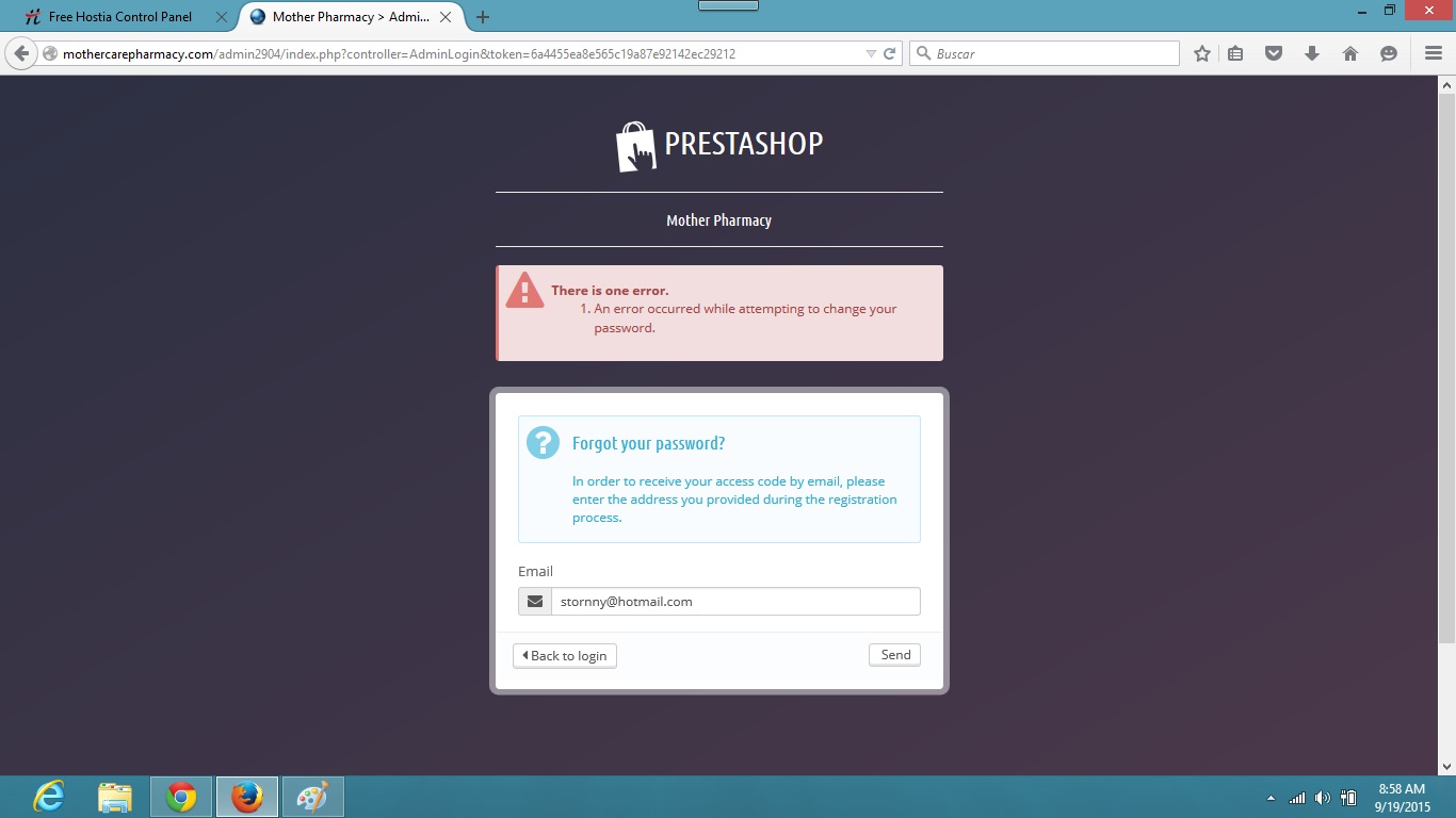

Thegame7777 Posted September 19, 2015 Share Posted September 19, 2015 I HAVE THIS ISSUE PLEASE HELP ME TO FIX NOW PRESTASHOP 1.6.0.14 Link to comment Share on other sites More sharing options...
