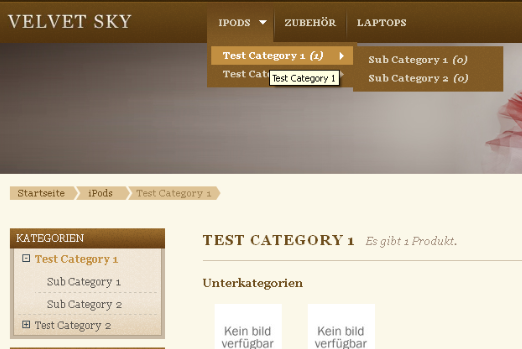

herchri Posted December 25, 2011 Author Share Posted December 25, 2011 Hi Snade, thanks for you reply. I already have a horizontal top menu. I've attached a screenshot of my actual test template. I want to change the left categories block. If I select the category 'iPods' in the horizontal top menu, only iPods and it's 2 subcategories should appear in the left category list. Do you know how to change it? thanks and kind regards Chris Link to comment Share on other sites More sharing options...

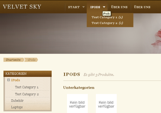

herchri Posted December 26, 2011 Author Share Posted December 26, 2011 Ok, looks much better now. Great. Now I've only one issue. I want, that the label of the left categories box - at the moment 'Kategorien' - gets automatically exchanged by the highest parent category - in my example 'iPods' - Does anyone have an idea for this? Link to comment Share on other sites More sharing options...
