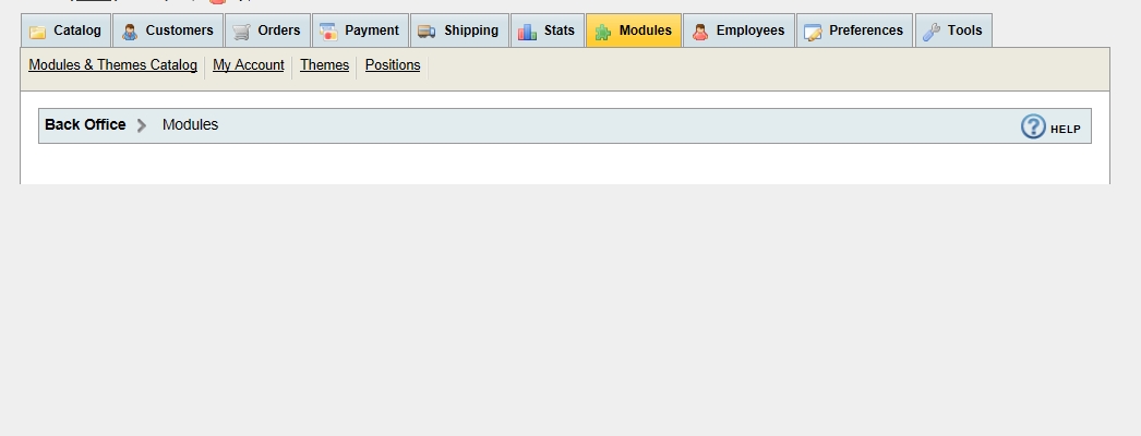

mrdibb Posted April 26, 2012 Share Posted April 26, 2012 Hi all I have just installed Prestashop (hoping to change from oscommerce). But the modules and payment tabs are not fully loading (see attachment). I have increased the memory limit to 128M in php.ini and config/config.inc.php - but it hasn't solved the problem. Any help would be appreciated! Thanks. Link to comment Share on other sites More sharing options...
mrdibb Posted May 1, 2012 Share Posted May 1, 2012 After some further investigation, it seems that if I remove all the modules then the page will load. But as soon as I install a module (even just 1!) then it fails to load. Can anyone help? Thanks. Link to comment Share on other sites More sharing options...
Carl Favre Posted May 2, 2012 Share Posted May 2, 2012 Hi mrdibb, Enable the debug mode to see what kind of error message you get on these pages. To do it, edit config.inc.php in \config folder and change /* Debug only */ @ini_set('display_errors', 'off'); define('_PS_DEBUG_SQL_', false); to /* Debug only */ @ini_set('display_errors', 'on'); define('_PS_DEBUG_SQL_', false); 1 Link to comment Share on other sites More sharing options...
