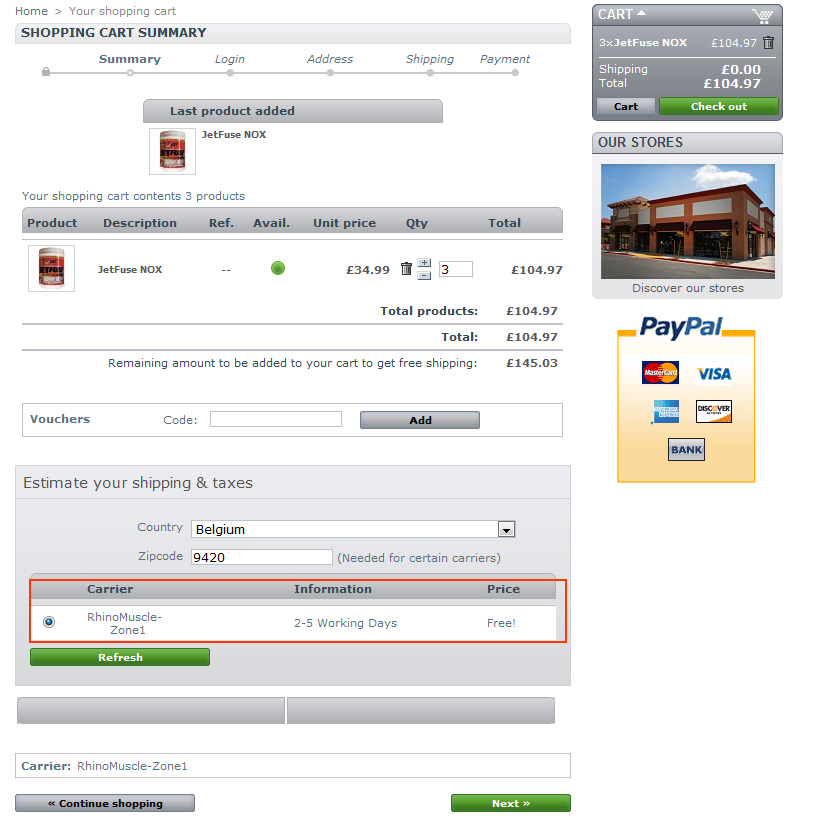

panism Posted December 4, 2011 Share Posted December 4, 2011 Hi everybody I have found that the shipping estimator only supplies a price when you have logged into the site. If you do not log in, it will show free shipping. Can somebody help me with that please? Im using prestashop 1.4.5.1 Link to comment Share on other sites More sharing options...

panism Posted December 5, 2011 Author Share Posted December 5, 2011 I check that... looks ok the default carrirer. Can you be more specific please? i have created carriers for different zones. On checkout, when u are not logged in, it finds the correct carrier when you enter your country on the "Estimate your shipping & taxes" but the shipping price is always free... Link to comment Share on other sites More sharing options...

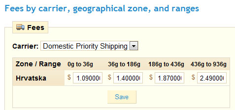

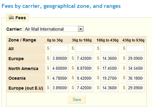

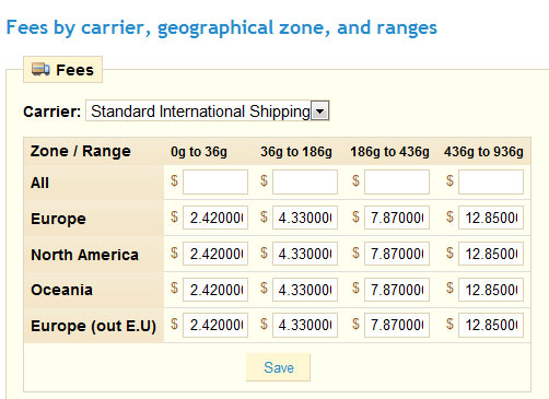

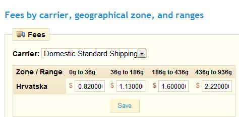

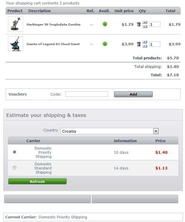

Dave L Posted January 16, 2012 Share Posted January 16, 2012 Problems like these are often as a result of incorrect price or weight ranges. Can you provide a screen shot of your ranges. Link to comment Share on other sites More sharing options...

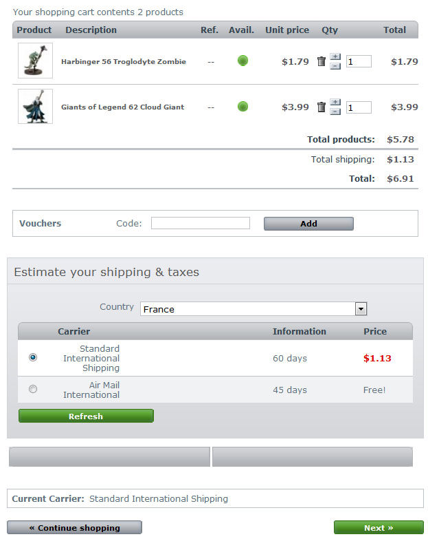

frost007 Posted January 20, 2012 Share Posted January 20, 2012 Problems like these are often as a result of incorrect price or weight ranges. Can you provide a screen shot of your ranges. Hi Dave, I attached the weight ranges for international carriers and domestic carries. Also, the results on Cart page for orders from Croatia (my home country which shows OK results) and the example of France which doesn't shows correct prices. I created special zone for the Croatia called "Hrvatska" and used default prestashop zones for other countries. Maybe that's the problem? Just thinking out loud... My site is not live yet as I would like to resolve this issue first. Thanks. Link to comment Share on other sites More sharing options...
Dave L Posted January 20, 2012 Share Posted January 20, 2012 Hi, Your weight ranges look fine. You shouldn't have a problem with your zones. Just to check, do you have a fee carrier set up at all? If so maybe Europe zone is selected in that carrier. Other than that, without BO access to browse your settings, I really can't why this happening. Link to comment Share on other sites More sharing options...
frost007 Posted January 20, 2012 Share Posted January 20, 2012 Hi, Your weight ranges look fine. You shouldn't have a problem with your zones. Just to check, do you have a fee carrier set up at all? If so maybe Europe zone is selected in that carrier. Other than that, without BO access to browse your settings, I really can't why this happening. Hi, no free carrier is not set for any zone or country. But, I descovered something else. If I change my default country to, for example, France in BO, then the shipping estimate shows correct numbers for France and Europe zone but incorrect for Croatia and other zones. Seems that shipping estimator works only for default country?! Link to comment Share on other sites More sharing options...
