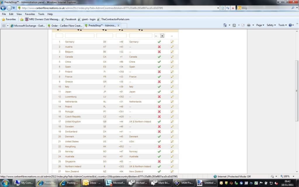

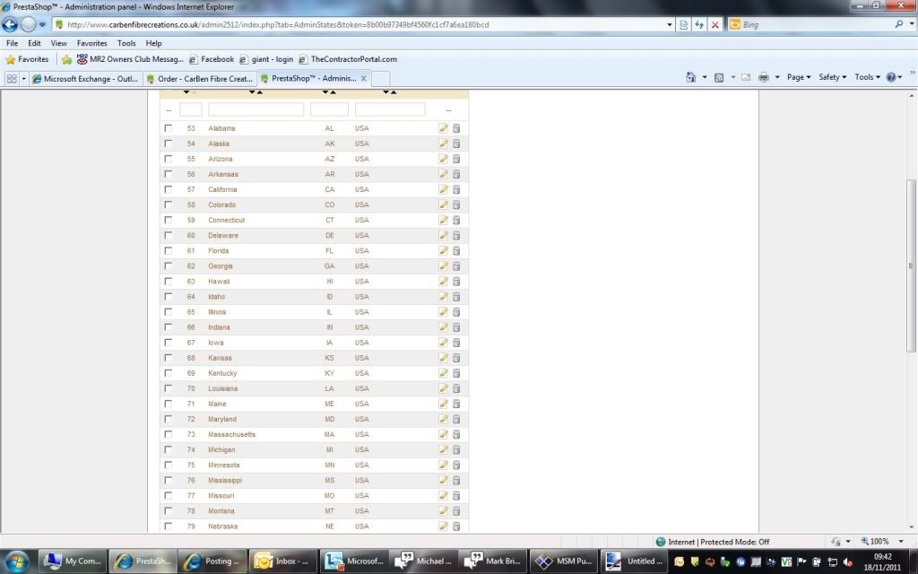

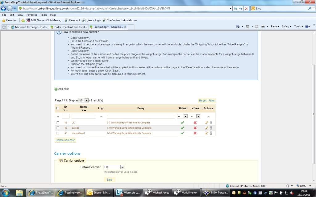

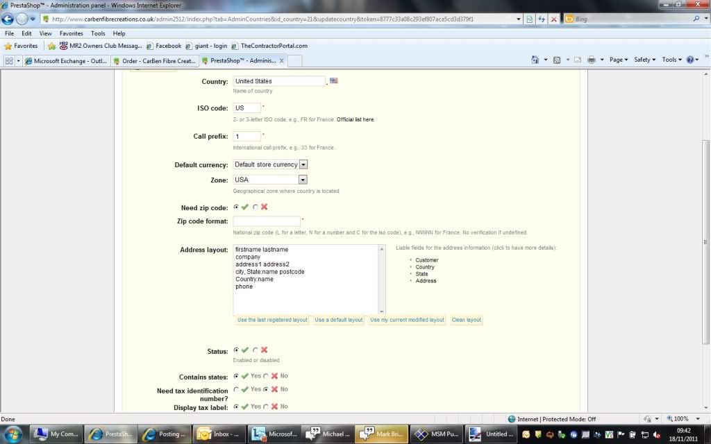

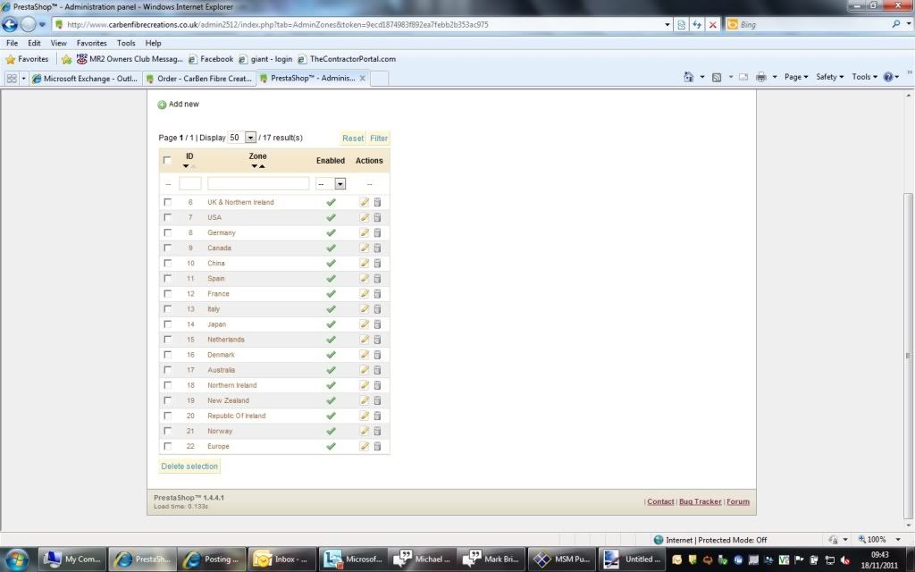

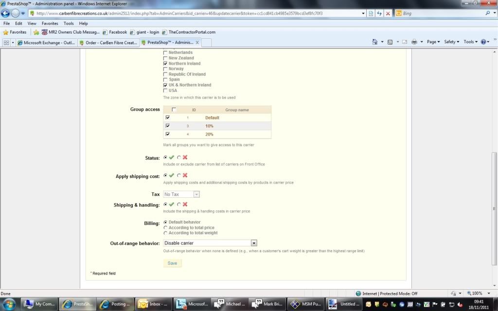

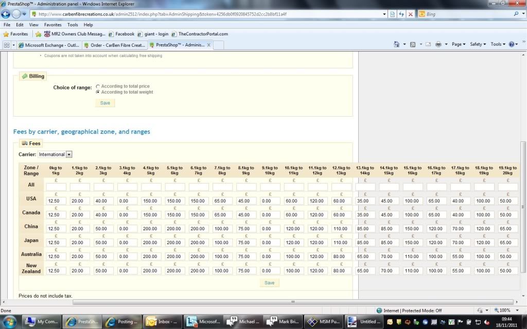

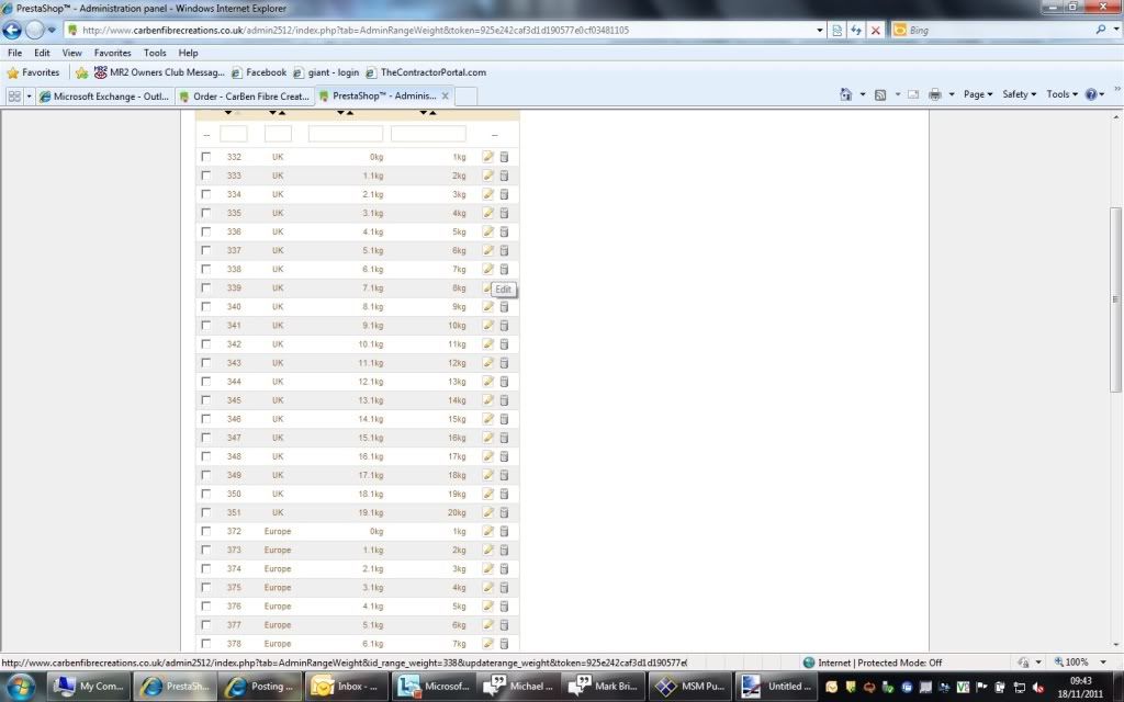

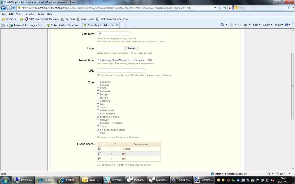

BenC Posted November 18, 2011 Share Posted November 18, 2011 Hi, I am in need of urgent help with shipping. I have spent the last day changing every item in my shop so it has a specific weight every item is different. I have then adjusted the carriers, weights and prices to reflect this but for some reason when I test it I get the error 'There are no carriers available that deliver to this address.' and I cant figure out why? Here are some screen shots to explain what I have done. Shipping prices by weight: Carriers: Carrier properties of UK, rest setup the same to reflect country (top photo) bottom photo: States, only used for USA Country setup Country Setup - USA specific Zones Weight Ranges: Can anyone see anything out of place im hoping its something very obvious that I have overlooked but I cant see it myself. Thanks Ben Link to comment Share on other sites More sharing options...

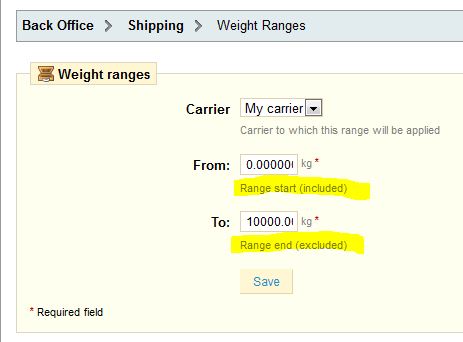

Dave L Posted November 18, 2011 Share Posted November 18, 2011 Many of your links show the same image so your setting cannot be seen. However, the first thing that jumps out are your weight ranges. You have gaps in them. Weight ranges are eclusive/inclusive which is from value 1 uo to but excluding value 2, from and including value 2 to but excluding value 3. etc. You should have: 0 kg - 1 kg 1 kg - 2 kg 2 kg - 3 kg etc.... Link to comment Share on other sites More sharing options...
BenC Posted November 18, 2011 Author Share Posted November 18, 2011 Hi sorry about that its fixed now. My weight ranges are setup like this below so they dont overlap, I was under the impression if you done it they way your suggesting and a product weighs 2kg how does it know which price it is as there are 2 entries 0 - 1 1.1 - 2 2.1 - 3 etc Link to comment Share on other sites More sharing options...
Dave L Posted November 18, 2011 Share Posted November 18, 2011 Hi Ben Because as explained the weight range is exclusive/inclusive. So in the above example: From 0 kg up to, but not including 1 kg From 1 kg up to, but not including 2 kg From 2 kg up to, but not including 3 kg So it your product is 2 kg it would fall into the From 2 kg up to, but not including 3 kg range. Link to comment Share on other sites More sharing options...
BenC Posted November 18, 2011 Author Share Posted November 18, 2011 So to adjust this and have it correct if all my products have sold 1,2,3kg weight I would need to change every range from 0 - 1kg 1.1 - 2kg to 0 -1.1 1.2 - 2.1 that would then include the correct weight? Link to comment Share on other sites More sharing options...
Dave L Posted November 18, 2011 Share Posted November 18, 2011 No, you still have gaps in your weight range. In your example tell me where a product weight of 1.15.kg fits in? And before you say 'but I don't have any products of that weight' it's not all to do with what products you have, it''s how the script works. Have a look where you enter a weight range, it tells you there (see attached image) But hey, it's your shop, you do whatever you wish. Link to comment Share on other sites More sharing options...
BenC Posted November 18, 2011 Author Share Posted November 18, 2011 I dont have any products that weight. Basically my products dont go by weight the weight is a reference number to the shipping cost. for example a rear panel might weigh 1kg in life but on the shop its down as 3kg because the postage isnt consistant to the weight when I quote. This way is a perfect setup for me and I can add endless amounts of weights and use that as a reference to one product with different prices accross the carriers. I know its probably not the way most people do it but its the only way I can with the nature of my business. What you have said has worked, all my products are now set how they should be Thanks very much for your help. Link to comment Share on other sites More sharing options...
