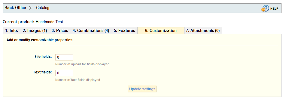

Mike Kranzler Posted November 11, 2011 Share Posted November 11, 2011 What using the 'customization' text input fields you mean? so set up 10 separate 'christmas order slot' products with no drop downs, just an input area where they state the baby hat and size by physically typing it in you mean? Thanks for this by the way, mike When creating the "order slot" product in your Back Office, you can add a text field field under "Customization" I hope this helps. -Mike Link to comment Share on other sites More sharing options...
