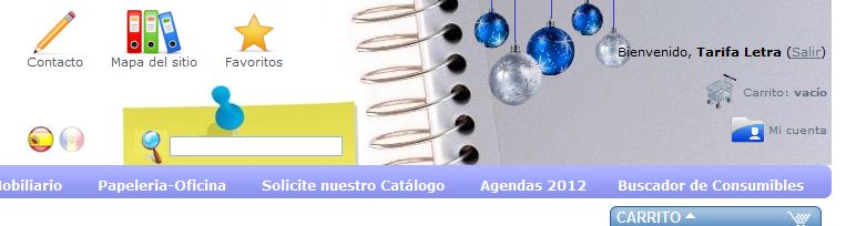

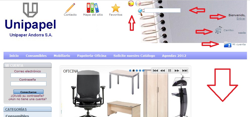

pemeclama Posted November 10, 2011 Share Posted November 10, 2011 I wonder if some kind soul can guide me ... I try to explain "briefly". If I open my site inFirefox, Chrome or Safari, I get the header without any problem: But if I open it with explorer 8, I get out of position some elements:.Also, the left column appears under the central column. The strange thing is that if you click on any product, items mysteriously return into their place. And if I open it with explorer 9, I have more problems!! If you want to see it live at: www.unipapel.ad Any ideas on this? I've been moving global.css for 2 months and I find no solution. Thanks Friend s Link to comment Share on other sites More sharing options...
phrasespot Posted November 13, 2011 Share Posted November 13, 2011 the left column appears under the central column. locate global.css line 210, change #right_column { padding-left: 15px; width: 190px; } to #right_column { padding-left: 5px; width: 190px; } For other problems I could not work on the page, too many things going on, crashing IE8; a seizure warning may be in order in case someone with epilepsy visits that page. You also have a few elements returning 404 (a module is trying to retrieve module files from Adobe, you may want to get that fixed.) Link to comment Share on other sites More sharing options...

pemeclama Posted December 10, 2011 Author Share Posted December 10, 2011 Hi Marty... I'm disappointed. I'd moved everything at global.css... but it does'nt work I have a month with this problem and can not find the solution. I explain. The site looks perfect in Firefox, Chrome and Safari (image etc.), but in Explorer I mismatch languages and the search box (image explorer).But more amazing is that only makes at home page! If you go to any other page, tables back where they belong. If you want to try it live: www.unipapel.ad Thanks for your time! Link to comment Share on other sites More sharing options...
pemeclama Posted December 11, 2011 Author Share Posted December 11, 2011 I forgot the image files... Sorry. Correct view --->"otros.jpg" Wrong view ---> "explorer.jpg" Link to comment Share on other sites More sharing options...
phrasespot Posted December 13, 2011 Share Posted December 13, 2011 in Explorer I mismatch languages and the search box (image explorer).But more amazing is that only makes at home page! If you go to any other page, tables back where they belong. That is because you added content outside the document and IE is reverting to quirks mode. Move the hitstats script into document body and everything will be OK Link to comment Share on other sites More sharing options...
