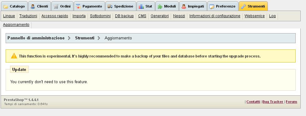

fida Posted October 26, 2011 Share Posted October 26, 2011 I have to upgrade Prestashop from the version 1.4.4.1 to the version 1.4.5.1 and I thought to use the inside function of updating but under the label UPDATE it tells me: You currently don't need to use this feature. Because it tells me this? How do I do for use this functionality? thanks Link to comment Share on other sites More sharing options...

Mike Kranzler Posted October 27, 2011 Share Posted October 27, 2011 Hi fida, Can you please post a screenshot of what you are seeing? -Mike Link to comment Share on other sites More sharing options...

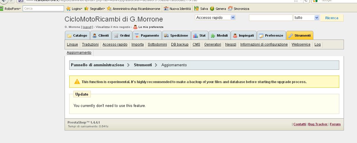

fida Posted October 27, 2011 Author Share Posted October 27, 2011 I have attached the screen shot Link to comment Share on other sites More sharing options...
fida Posted October 27, 2011 Author Share Posted October 27, 2011 this other image is more complete Link to comment Share on other sites More sharing options...
Mike Kranzler Posted October 27, 2011 Share Posted October 27, 2011 Hi fida, On your Back Office dashboard, do you currently get a message that says "new version available"? -Mike Link to comment Share on other sites More sharing options...
fida Posted October 27, 2011 Author Share Posted October 27, 2011 Yes, In the home page of backoffice it tell me that there is a new version :1.4.5.1 Link to comment Share on other sites More sharing options...
Mike Kranzler Posted October 27, 2011 Share Posted October 27, 2011 Have you already downloaded the autoupgrade module? -Mike Link to comment Share on other sites More sharing options...
fida Posted October 27, 2011 Author Share Posted October 27, 2011 hi mike, I haven't downloaded this module, I thought that this module was already integrated in the version 1.4.4.1. Can you give me the link for download it ? thanks for you help Link to comment Share on other sites More sharing options...
Mike Kranzler Posted October 27, 2011 Share Posted October 27, 2011 Ahhhh there we go. I knew we had to be missing something . Go ahead and grab the latest version in my first post here. -Mike Link to comment Share on other sites More sharing options...
