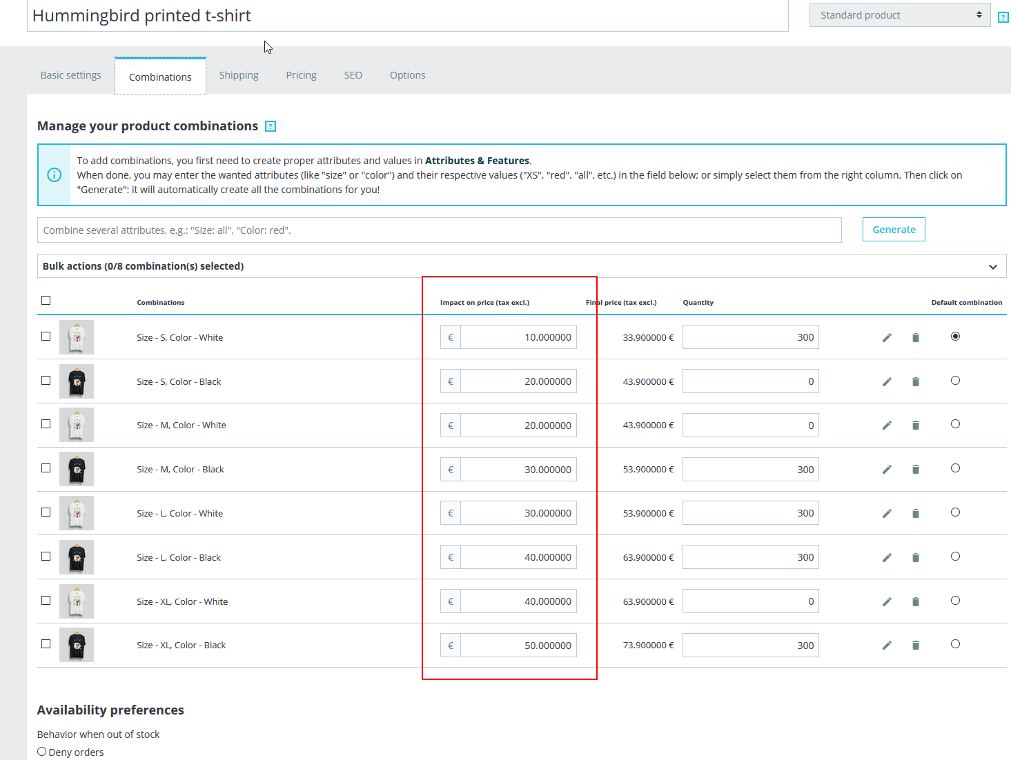

Martin
Create an attribute (e.g. content in ml). Then assign the corrspoding values to it (e.g. 50ml, 100ml, 200ml). Then create a product with combinations and assign the needed values in the combination tab. Then you can assign a price impact to each combination.
Example:
