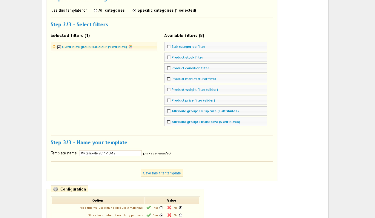

gennybeans Posted October 19, 2011 Author Share Posted October 19, 2011 So, it seems that it was a browser cache issue. I have that fixed. Except my layered navigation block still isn't appearing on the front-end (even after enabling the module, and creating multiple templates). I've attached a screenshot of the BO of the module. Link to comment Share on other sites More sharing options...
Mike Kranzler Posted October 19, 2011 Share Posted October 19, 2011 Hi gennybeans, Can you please post your URL so that I can check this out for you? -Mike Link to comment Share on other sites More sharing options...
gennybeans Posted October 20, 2011 Author Share Posted October 20, 2011 Hi Mike, I'm actually working on it locally. It is not uploaded or live yet. =/ Any other way around that? Link to comment Share on other sites More sharing options...
Mike Kranzler Posted October 20, 2011 Share Posted October 20, 2011 Hi gennybeans, Can you please check the Module positions in your back office to see where the layered navigation block is currently hooked on your site? -Mike Link to comment Share on other sites More sharing options...
gennybeans Posted October 20, 2011 Author Share Posted October 20, 2011 It is currently hooked to the Left Column, Header of Pages and Footer. Note: Before checking the hooks, I had no clue it was hooked to so many parts of the page. I only want it in the Left Column. Edit: I also want to point out that when I run the Live Edit, the block appears (in the left column) but is empty. Edit pt. 2: My, my! It seems like it has appeared! It shows up once I click on one of the categories. Is it possible for it to appear on the front page as well? Maybe placing it in another hook? I had removed it from the Header of Pages and Footer hooks. It didn't seem to mess it up. Link to comment Share on other sites More sharing options...
Mike Kranzler Posted October 20, 2011 Share Posted October 20, 2011 Hi gennybeans, This may seem stupid, but in your Back Office, please go to Modules and set the dropdown menus to show "Installed Modules" and "Enabled & Disabled." Once you've done that, please look for the Layered Navigation module and check to see if it is currently enabled. I suggest this because I just did a clean install of the 1.5 theme to test this for you, and it is actually NOT enabled by default, even if you are able to edit the module. Please let me know if that works for you! -Mike Link to comment Share on other sites More sharing options...
gennybeans Posted October 20, 2011 Author Share Posted October 20, 2011 Hi Mike! Thank you. I ended up editing my last post. It actually started to work, but still does not show on the main page. I'm beginning to realize that it isn't that big of a deal, even though it would be nice. I couldn't seem to hook the Layered Navigation to anything else, so I guess I will have to stick with what I've got. Thank you so much for all your help! It's been greatly appreciated. Link to comment Share on other sites More sharing options...
