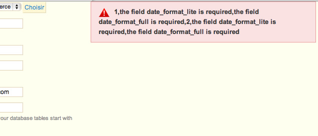

airbuzz Posted October 27, 2011 Share Posted October 27, 2011 Hi, I exactly have the same problem with the OsCommerce importer. here is the message: " 1,the field date_format_lite is required,the fielddate_format_full is required,2,the field date_format_lite is required,the field date_format_full is required " Please see the attached picture. I tried to check where those variables in the code but i couldn t find it. Anyone knows where this error could come from ? Thank you in advance, Link to comment Share on other sites More sharing options...

airbuzz Posted October 28, 2011 Share Posted October 28, 2011 still trying to find out where to modify the code. May be some admin could give some clues. Here is the JSON response : {"hasError":true,"datas":[{"id_lang":"1","name":"Fran\u00e7ais","iso_code":"fr","active":"1"},{"id_lang":"2","name":"Anglais","iso_code":"en","active":"1"}],"error":[["1","the field <b>date_format_lite</b> is required"," the field <b>date_format_null</b> is required"]]]} Help please ! Link to comment Share on other sites More sharing options...
