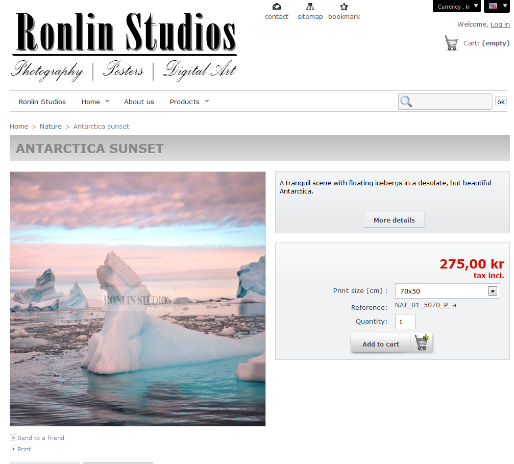

ronlin-9 Posted February 8, 2012 Share Posted February 8, 2012 My watermark is not showing up on my images despite uploading .gif image, regenerating thumbnails, having force compile on etc. I can´t see the watermark module being hooked to anything under Modules->Positions is this the problem? Thanks! Link to comment Share on other sites More sharing options...
Mike Kranzler Posted February 8, 2012 Share Posted February 8, 2012 Hi ronlin, Please sure to clear your browser's cache as well. Everything looks fine on my end with the watermarks. Originally, it didn't because I had accessed your site yesterday, but once clearing my cache everything showed up properly. Please let me know if that works for you. -Mike Link to comment Share on other sites More sharing options...
