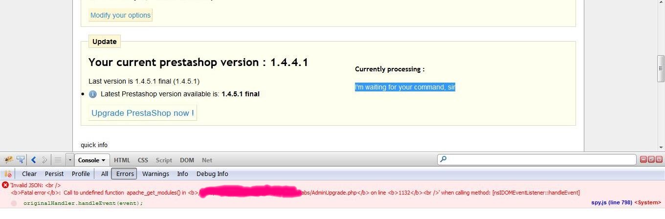

soroosh Posted October 18, 2011 Share Posted October 18, 2011 I have problem with auto update: I face with suspended "Currently processing : I'm waiting for your command, sir" message. After updating the AdminUpgrade.php file (with commenting line:1117) I faced with suspended : Currently processing : All sample files removed. Now backup files. message! Link to comment Share on other sites More sharing options...
Mike Kranzler Posted October 18, 2011 Share Posted October 18, 2011 Hi soroosh, Can you please post a screenshot of the error you're encountering? -Mike Link to comment Share on other sites More sharing options...
soroosh Posted October 18, 2011 Share Posted October 18, 2011 Hi Mike Actually this is not an error. But is an stop point for the upgrade progress. Screen shot attached. Link to comment Share on other sites More sharing options...
Mike Kranzler Posted October 18, 2011 Share Posted October 18, 2011 Hi soroosh, Do you get any message or warning, or anything that would tell you that the upgrade has failed? -Mike Link to comment Share on other sites More sharing options...
soroosh Posted October 18, 2011 Share Posted October 18, 2011 On 10/18/2011 at 6:51 PM, Mike Kranzler said: Hi soroosh, Do you get any message or warning, or anything that would tell you that the upgrade has failed? -Mike No, I don't get any message or warning. Just freeze with this message: Currently processing : All sample files removed. Now backup files. Link to comment Share on other sites More sharing options...
Mike Kranzler Posted October 18, 2011 Share Posted October 18, 2011 Hi soroosh, It is possible that this is an issue with your server speed and timeout settings. If you have access to the file php5.ini in your root directory, please try changing max_execution_time from 30 to 300 and see if that solves it for you. If you don't have access to this, please ask your hosting provider to do this for you. I hope this helps. -Mike Link to comment Share on other sites More sharing options...
soroosh Posted October 19, 2011 Share Posted October 19, 2011 I asked from hosting support about the max_execution_time and they said that it sets on 300 but the problem exists. Is there anyway to upgrade 1.4.4.1 to 1.4.5.1 manually without losing data and customizations? Link to comment Share on other sites More sharing options...

soroosh Posted October 21, 2011 Share Posted October 21, 2011 But for unknown reasons I had to upgrade it manually Link to comment Share on other sites More sharing options...
Mike Kranzler Posted October 21, 2011 Share Posted October 21, 2011 On 10/21/2011 at 10:01 AM, soroosh said: But for unknown reasons I had to upgrade it manually Hi soroosh, I'm sorry to hear that the autoupgrade module didn't work properly for you, but can you confirm that you were successful in upgrading manually? -Mike 1 Link to comment Share on other sites More sharing options...
soroosh Posted October 21, 2011 Share Posted October 21, 2011 Hi Mike Yes, I could successfully upgrade it manually! Link to comment Share on other sites More sharing options...
Mike Kranzler Posted October 21, 2011 Share Posted October 21, 2011 On 10/21/2011 at 2:19 PM, soroosh said: Hi Mike Yes, I could successfully upgrade it manually! Great! I'm glad that you were able to upgrade. Enjoy 1.4.5!! -Mike 1 Link to comment Share on other sites More sharing options...

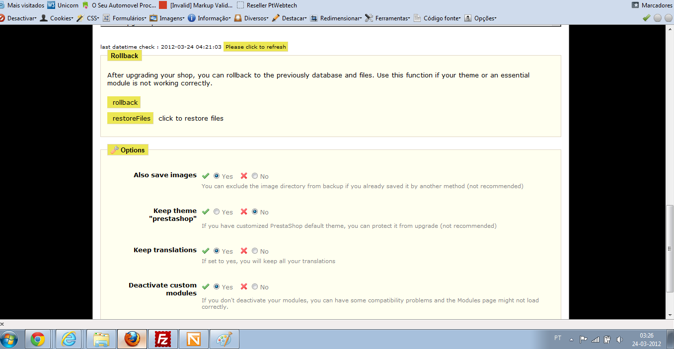

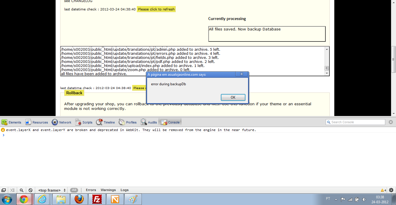

exadra37 Posted March 24, 2012 Share Posted March 24, 2012 Hello, I want to give the congratulions to the author off this FAQ. I am trying to upgrade from version 1.2.5.0 with this module but i get the error: - Error during backupDB. My version don´t have memchache. I send some screen shots. Link to comment Share on other sites More sharing options...
