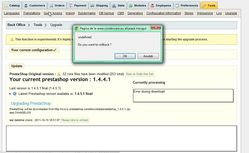

ivpinstal Posted October 15, 2011 Share Posted October 15, 2011 a facut cineva upgrade de la 1.4.4.1 la 1.4.5.1 ..? Am tot incercat, dar nici macar nu apuca procesul de upgrade sa inceapa, ca-mi da eroare. -am scris si aici Link to comment Share on other sites More sharing options...

ivpinstal Posted October 17, 2011 Author Share Posted October 17, 2011 On 10/17/2011 at 1:28 PM, vietnam said: ..upgrade-guide ok, am citit ghidul, am citit si altele, dar .. upgrade-ul nici nu porneste -vezi printscreen de mai sus.-m-am conversat in PM si cu M. marinetti -si nu i-a dat de cap... Link to comment Share on other sites More sharing options...

Rhobur Posted October 20, 2011 Share Posted October 20, 2011 Solutia este sa redenumesti arhiva prestashop 1.45.1 in prestashop.zip si sa o pui manual in directorul tau admin/autoupgrade. Robert On 10/15/2011 at 2:17 PM, ivpinstal said: a facut cineva upgrade de la 1.4.4.1 la 1.4.5.1 ..? Am tot incercat, dar nici macar nu apuca procesul de upgrade sa inceapa, ca-mi da eroare. -am scris si aici Link to comment Share on other sites More sharing options...
ivpinstal Posted October 20, 2011 Author Share Posted October 20, 2011 ok .. n-a mers. am uploadat 1.4.5.1 in dir-ul meu admin/autoupgrade/ ..l-am lasat acolo zip-uit si am incercat update.. N-a mers. Nu cred ca poate functiona atat timp cat n-am modificat nici-un fisier in care sa indic sa se faca download-ul de la locatia aceea... Link to comment Share on other sites More sharing options...
Rhobur Posted October 21, 2011 Share Posted October 21, 2011 L-ai redenumit in prestashop.zip ( fara 14.5.1 ) ? La mine a mers, calea este setata implicit in AdminSelfUpgrade.php. Link to comment Share on other sites More sharing options...
ivpinstal Posted October 21, 2011 Author Share Posted October 21, 2011 ai dreptate, nu l-am redenumit: am facut-o insa acum.. Am uploadat apoi acest prestashop.zip in admin/autoupgrade/ si am incercat.. Apoi l-am pus in admin/autoupgrade/latest/ si tot n-a mers. N-am gasit calea indicata in AdminSelfUpgrade.. pe la ce linie de program e ? pe pagina web de admin prestashop scrie (sub Upgrade prestasop now): PrestaShop will be downloaded from http://www.prestashop.com/download/prestashop_1.4.5.1.zip see CHANGELOG Link to comment Share on other sites More sharing options...
Crisplant Posted October 22, 2011 Share Posted October 22, 2011 Eu am reusit sa fac upgrade de la 140 la 145 cu acel fisier autoupgrade. Dar, dupa toate acestea, imi da o eroare (vezi atasament) Cine ma ajuta sa rezolv problema asta? Multumesc. Link to comment Share on other sites More sharing options...
ivpinstal Posted October 26, 2011 Author Share Posted October 26, 2011 On 10/15/2011 at 2:17 PM, ivpinstal said: a facut cineva upgrade de la 1.4.4.1 la 1.4.5.1 ..? Am tot incercat, dar nici macar nu apuca procesul de upgrade sa inceapa, ca-mi da eroare. -am scris si aici pana la urma am facut upgrade-ul manual: a mers fara probleme, site-ul e functional.-nu-mi explic de ce n-a functionat modulul autoupgrade. Link to comment Share on other sites More sharing options...
