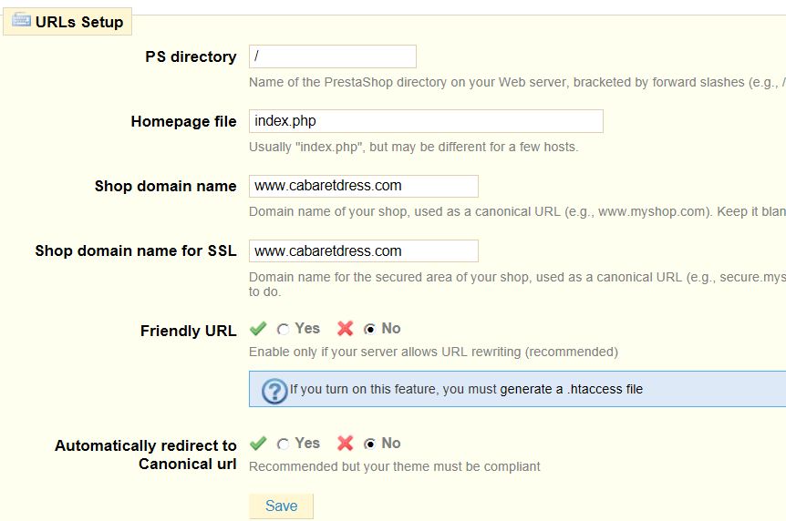

cedricfontaine Posted October 14, 2011 Share Posted October 14, 2011 As tu modifié dans les paramètres de Prestashop le nom du dossier ? Car il ne suffit pas de déplacer le répertoire, il faut aussi changer la configuration... Link to comment Share on other sites More sharing options...
chichoune Posted October 14, 2011 Author Share Posted October 14, 2011 bonsoir, tu parles dans la partie seo&url? http://www.hostingpics.net/viewer.php?id=849614Sanstitre.jpg Link to comment Share on other sites More sharing options...

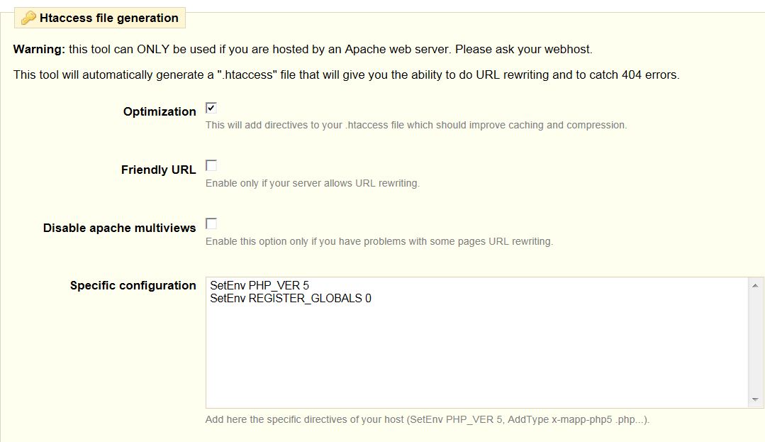

lolek59 Posted October 19, 2011 Share Posted October 19, 2011 Bonjour Eolia, comme demandé j'ai donc désactivé la redirection et regénéré le htacces, sans changement :-( voici le detail et des captures d'écran au cas ou ! par contre le htaccess il y a plus grand chose dedans ?? # .htaccess automaticaly generated by PrestaShop e-commerce open-source solution # WARNING: PLEASE DO NOT MODIFY THIS FILE MANUALLY. IF NECESSARY, ADD YOUR SPECIFIC CONFIGURATION WITH THE HTACCESS GENERATOR IN BACK OFFICE # http://www.prestashop.com - http://www.prestashop.com/forums SetEnv PHP_VER 5 SetEnv REGISTER_GLOBALS 0 <IfModule mod_rewrite.c> # URL rewriting module activation RewriteEngine on # URL rewriting rules RewriteRule ^api/?(.*)$ /webservice/dispatcher.php?url=$1 [QSA,L] </IfModule> # Catch 404 errors ErrorDocument 404 /404.php <IfModule mod_expires.c> ExpiresActive On ExpiresByType image/gif "access plus 1 month" ExpiresByType image/jpeg "access plus 1 month" ExpiresByType image/png "access plus 1 month" ExpiresByType text/css "access plus 1 week" ExpiresByType text/javascript "access plus 1 week" ExpiresByType application/javascript "access plus 1 week" ExpiresByType application/x-javascript "access plus 1 week" ExpiresByType image/x-icon "access plus 1 year" </IfModule> FileETag INode MTime Size <IfModule mod_deflate.c> AddOutputFilterByType DEFLATE text/html AddOutputFilterByType DEFLATE text/css AddOutputFilterByType DEFLATE text/javascript AddOutputFilterByType DEFLATE application/javascript AddOutputFilterByType DEFLATE application/x-javascript </IfModule> Link to comment Share on other sites More sharing options...

lolek59 Posted October 19, 2011 Share Posted October 19, 2011 Je viens de ré-editer mon htaccess et j'y ai remit les ligne : SetEnv PHP_VER 5 SetEnv REGISTER_GLOBALS 0 du coup suis revenu à l'état anterieur :-( Link to comment Share on other sites More sharing options...

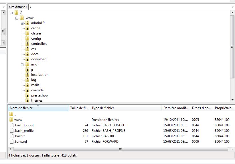

Eolia Posted October 19, 2011 Share Posted October 19, 2011 c'est quoi ce répertoire prestashop entre override et themes ? Ton site est bancal car certaines pages sont accessibles, mais sans la mise en forme d'arrière plan: ex: http://www.cabaretdress.com/robes/10-test-roba.html Link to comment Share on other sites More sharing options...
lolek59 Posted October 19, 2011 Share Posted October 19, 2011 c'est quoi ce répertoire prestashop entre override et themes ? Ton site est bancal car certaines pages sont accessibles, mais sans la mise en forme d'arrière plan: ex: http://www.cabaretdr...-test-roba.html C'est mon ancien repertoire ou se trouvait tout le dossier, je viens de le supprimer car effectivement maintenant il est vide et ne sert donc à rien. J'avais effectivement fait le test de mon coté en tapant une ligne type http://www.cabaretdress.com/pinceaux-blush-rouge/121-pinceau-p4-16.html et effectivement cela s'affichait sans avoir la mise en forme :-( Link to comment Share on other sites More sharing options...
Eolia Posted October 19, 2011 Share Posted October 19, 2011 Bon rendu à ce point là voilà ce que je ferais: 1)Sauvegarde ton fichier config 2)Vide ton répertoire www (conserve éventuellement des fichiers que tu aurais modifiés ou rajoutés, modules, etc...) 3)Réinstalle une version de Prestashop avec une nouvelle base de donnée (un nom différent de celle d'origine) 4)remplace le nouveau dossier config par celui que tu as sauvegardé et remets tes fichiers sauvegardés 5)Supprime la nouvelle base de données 6) TEST ! Si tu es inquiet, sauvegarde l'ensemble de ton répertoire www sur ton pc avant la manip. Link to comment Share on other sites More sharing options...

lolek59 Posted October 20, 2011 Share Posted October 20, 2011 Je viens de comparer tous les dossiers, j'ai effectivement perdu le dossier modules à la racine :-( !! suis donc en train de le replacer mais du coup je dois de nouveau personnaliser tous les blocks !! Link to comment Share on other sites More sharing options...
Eolia Posted October 20, 2011 Share Posted October 20, 2011 effectivement, je n'avais pas vu qu'il te manquait ce répertoire, pourtant indispensable ! Tes fiches produits sont stockées dans la base de donnée, donc pas d'inquiétude à avoir. Link to comment Share on other sites More sharing options...
