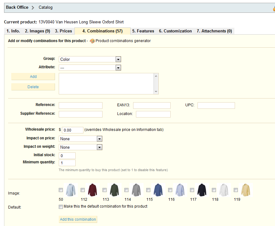

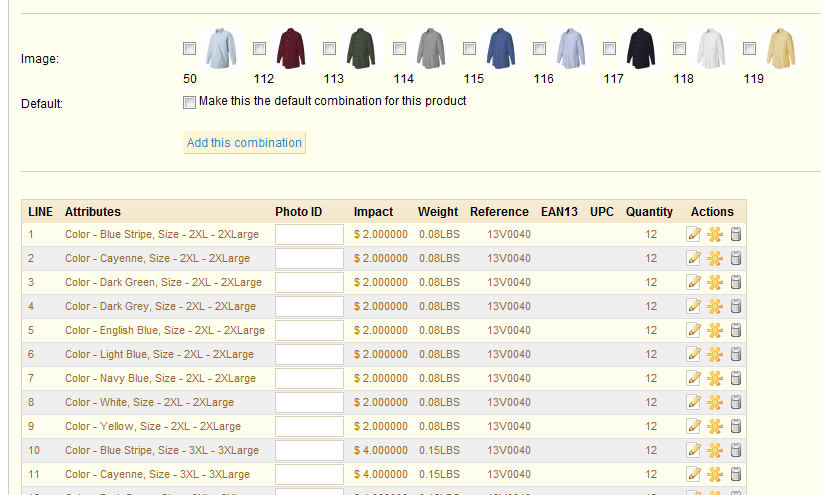

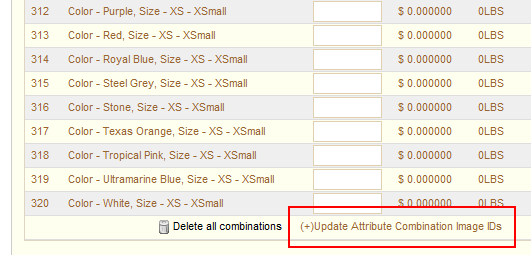

tsunow Posted October 13, 2011 Share Posted October 13, 2011 I have included three screen shots of what I am attempting to accomplish to compliment the following changes I am trying to attempt In shops with LARGE amounts of product combinations, attaching photos to the correct attribute combination can be daunting. What I am attempting to do is commit a mass change using text box input. The first change I have added was making the Photo ID of the uploaded photos visible. The second change I have added was two part - I added line item numbers for convenience and then added the PhotoID Column that represents the expected input as shown in the first Image. The Last Change - And the one with which I need help is the commit link. Just like being able to remove all product combinations in one action, I'd like to commit all the PhotoID relationships to their corresponding Attribute Combinations in One Action Can someone help with providing the correct code to do this? I am at a loss. Link to comment Share on other sites More sharing options...
