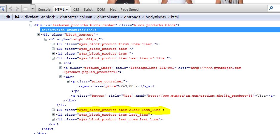

Dennis Demirtok Posted October 10, 2011 Share Posted October 10, 2011 Hi! i need some help with my website! www.gymkedjan.com - on the home featured, its two in the middle that is always emty. it just puts it one line down. not fulling the line 2. if you understand me. hope i can work it out. best regards dennis Link to comment Share on other sites More sharing options...
Dave L Posted October 10, 2011 Share Posted October 10, 2011 Have you configured the Home Featured to show how many items to show. The default is set to '0'. Otherwise, you could try to reset the module in BO. Link to comment Share on other sites More sharing options...
Dennis Demirtok Posted October 10, 2011 Author Share Posted October 10, 2011 i have set it too 16 i think, but its just like its something with the 2 line becuase the first and the 3 looks good. I have modified the home featured so its so much work to reset? best regards Link to comment Share on other sites More sharing options...
Dave L Posted October 10, 2011 Share Posted October 10, 2011 Ah! you didn't mention you had modified your file. Having a look using Firebug with Firefox it looks like the highlighted line in the attached image needs moving to the bottom of the list. I think this is the .tpl file you modified. Link to comment Share on other sites More sharing options...
Dennis Demirtok Posted October 10, 2011 Author Share Posted October 10, 2011 what do you think i should modify? should i delete that line you have yellow in the attached file? thansk for your answers! best regards! Link to comment Share on other sites More sharing options...
Dave L Posted October 10, 2011 Share Posted October 10, 2011 Well, if its a line that you haven't added it's probably supposed to be there. It's just that it's not in the position it was originally. You could move the line down and see what effect it has. Back up the file before you change it though. Alternatively, have a look at an original copy of the file from your original download and compare that section of code. It may provide the clues you need to rectify the problem. Link to comment Share on other sites More sharing options...
