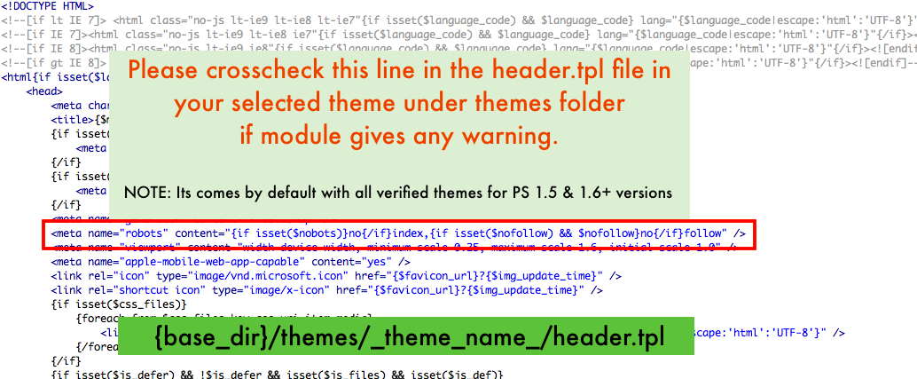

srana Posted February 1, 2016 Share Posted February 1, 2016 (edited) Here is the perfect module for you all those are in need to use NOINDEX or NOFOLLOW options on different pages for better SEO. SEO NOindex,follow (handles Duplicate content) Module Features: - Canonical url for Category, New Product, Top Sellers, Price Drop, Suppliers, Manufacturers, pagination (?p=1,p=2..) to avoid duplicate content for SEO. - Optimize search results for all search engines - Get rid of mass indexing for unnecessary pages. - Set FOLLOW/ NOFOLLOW option for each page. - Set INDEX/ NOINDEX option for each page. - Set INDEX & FOLLOW options for Categories, Products, CMS, CMS Categories, Default and Modules pages. - Select YES/ NO All and UNDO buttons to set options quickly. - Update ROBOTS.TXT file from module configuration directly. Edited March 21, 2018 by srana solution is updated. (see edit history) Link to comment Share on other sites More sharing options...
