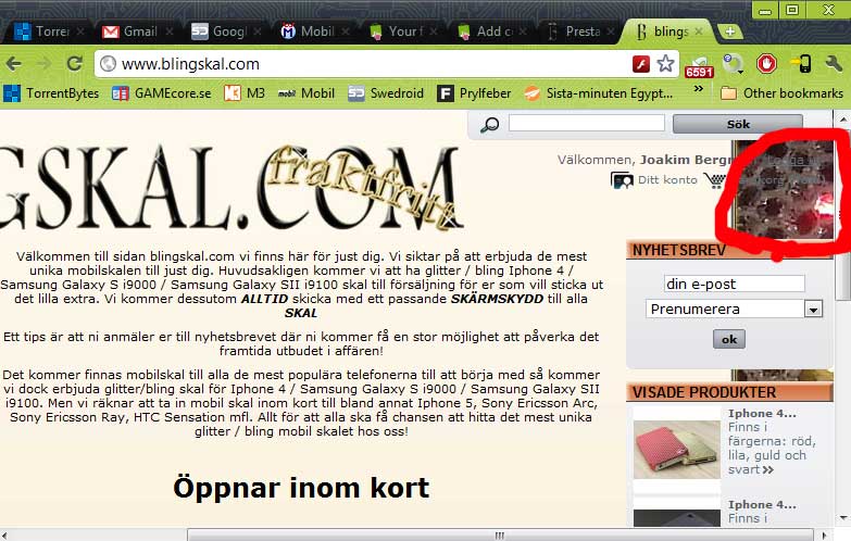

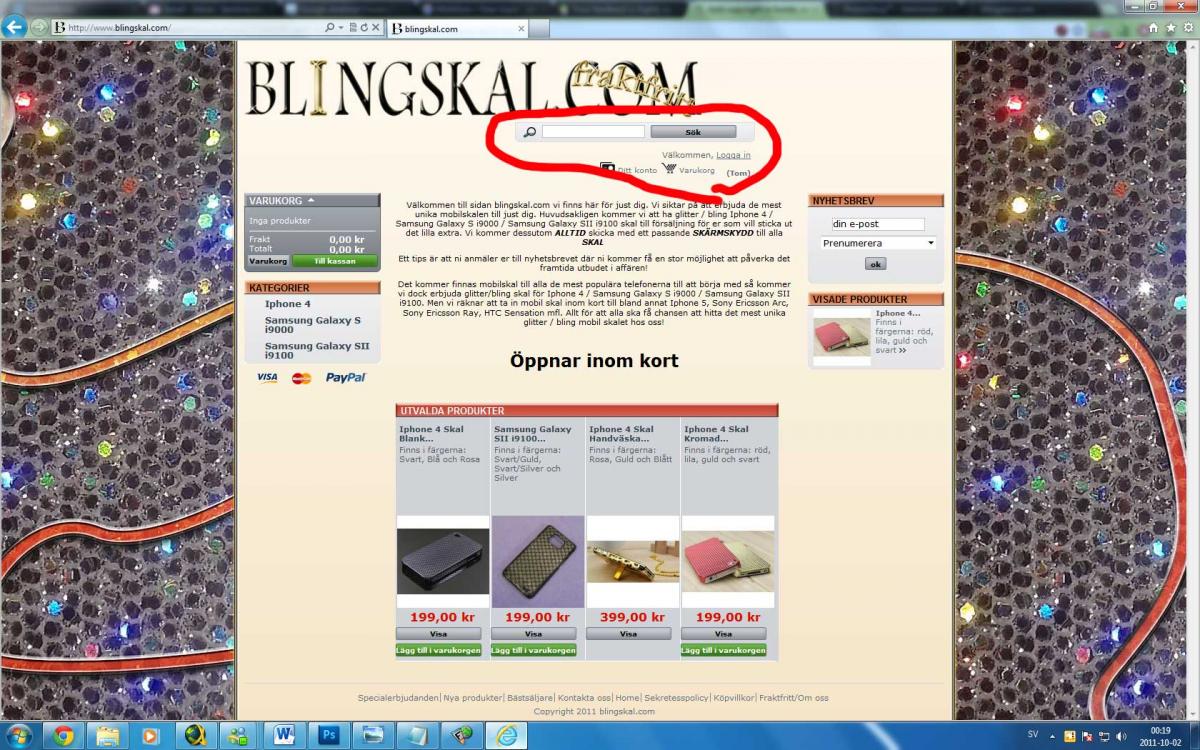

benknackan Posted October 1, 2011 Author Share Posted October 1, 2011 Actually when using original theme it's as described earlier. But now with my theme the footer doesnt break, it's just the search button and account stuff that get placed way too low. And in chrome it breaks the centering of background... Or is it just me? Anyhow attached images on how it looks for me and marked what's wrong Link to comment Share on other sites More sharing options...
