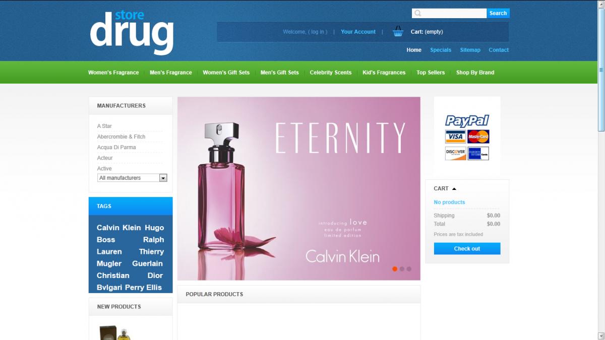

ScentSplash Posted September 30, 2011 Share Posted September 30, 2011 Hi, Thanks in advance for any advice that may be offered. From the admin I went to Prefrences > Performance. From the caching section I changed the use cache from off to on. I then pressed save. On the live site, http://www.scentsplash.com this had the effect of moving all the modules in the third column to the bottom of the center section. I then turned cache off bu that did not restore the 3rd column. I have not been been able to restore these modules to the 3rd column. I tried live edit but the modules will not move to 3rd or 1st column. They just snap back to the center. I tried uninstalling and installing them to no effect. From the transplant a module page I see they are attached to the following hooks. Right column blocks - 1 module Header of pages - 1 module I am using version 1.4.0.17. Thanks agin for any suggestions. Link to comment Share on other sites More sharing options...

Carolina Custom Designs Posted October 1, 2011 Share Posted October 1, 2011 Hi ScentSplash! I looked at your site and found the problem. You currently have the RH column within the center column div. You need to close the div before the RH column. I closed the div then snap a screen shot to show you that it worked. Hope this helps! Marty Shue Link to comment Share on other sites More sharing options...

ScentSplash Posted October 1, 2011 Author Share Posted October 1, 2011 Hi Marty, Sorry to be so dense but I can't find the open div. I looked in footer.tpl, copy below. I have also looked in several other files but being new to prestashop I am not that familiar with what file controls what. If you could let me now what file to look in I would be most appreciative. Thanks again! {if !$content_only} </div> <!-- Right --> <div id="right_column" class="column"> {$HOOK_RIGHT_COLUMN} </div> </div> <!-- Footer --> <div id="footer">{$HOOK_FOOTER}</div> </div> {/if} </body> </html> Link to comment Share on other sites More sharing options...
Carolina Custom Designs Posted October 1, 2011 Share Posted October 1, 2011 Hi Marty, Sorry to be so dense but I can't find the open div. I looked in footer.tpl, copy below. I have also looked in several other files but being new to prestashop I am not that familiar with what file controls what. If you could let me now what file to look in I would be most appreciative. Thanks again! {if !$content_only} </div> <!-- Right --> <div id="right_column" class="column"> {$HOOK_RIGHT_COLUMN} </div> </div> <!-- Footer --> <div id="footer">{$HOOK_FOOTER}</div> </div> {/if} </body> </html> You should be able to place a close </div> right before the 'Rght' column. This is what I did and it moved the right column in the proper place. For some reason the right column is currently within the center column. Let me know if you need more help. Marty Shue Link to comment Share on other sites More sharing options...
ScentSplash Posted October 1, 2011 Author Share Posted October 1, 2011 Hi Marty, Thanks again for your help and my apologies for not getting this. I edited the below file /public_html/themes/theme156/footer.tpl and then added the closed div. You can see it in the below copy of the file. Am I in the wrong file or am I placing the closed div incorrectly? {if !$content_only} </div> </div> <!-- Right --> (ADDED THS CLOSED DICV </div> <div id="right_column" class="column">{$HOOK_RIGHT_COLUMN}</div> </div> </div> <!-- Footer --> <div id="footer_wrapper"> <div id="footer"> {$HOOK_FOOTER} <!-- [[%FOOTER_LINK]] --> </div> </div> </div> </div> {/if} </body> </html> Thanks again Tyler Link to comment Share on other sites More sharing options...
ScentSplash Posted October 1, 2011 Author Share Posted October 1, 2011 Hi Marty, Just figured out. Thanks again for your help and patience. Tyler Link to comment Share on other sites More sharing options...
