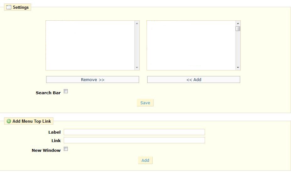

dazzza Posted September 28, 2011 Share Posted September 28, 2011 Label: Home (or what ever you want to call your main page) Link: index.php Then add. Then find it in the right hand window at the top, selected it & click add to move it to the left window showing what's on your menu bar. Link to comment Share on other sites More sharing options...

dazzza Posted September 28, 2011 Share Posted September 28, 2011 See picture attached. After adding your link index.php it should appear in the top right window. Select it & click add under the right window & it will appear in the left window. Links in the left window are the links that appear on your top menu on the site. Link to comment Share on other sites More sharing options...
