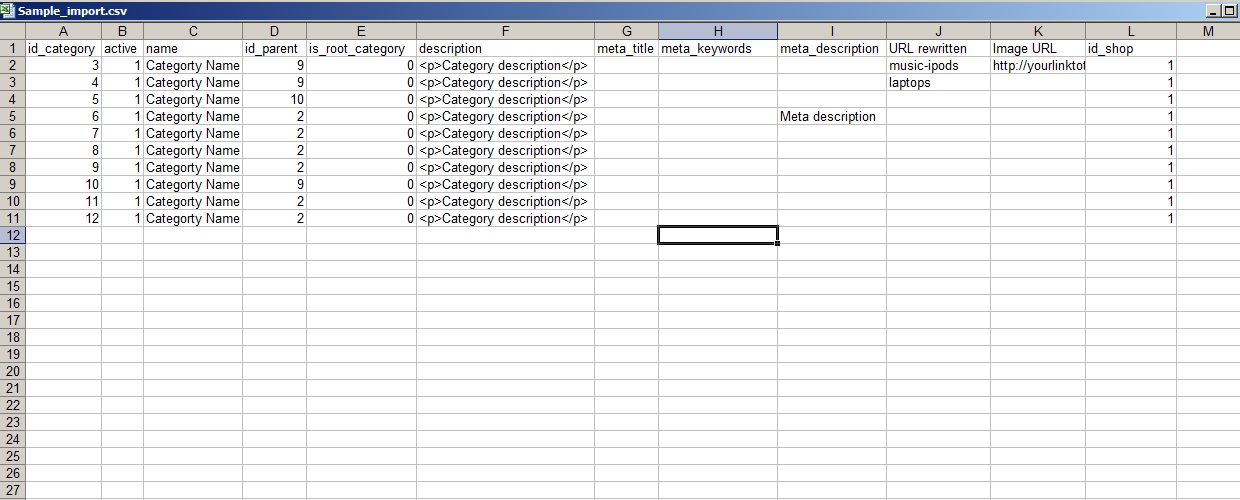

Star Posted February 17, 2009 Share Posted February 17, 2009 Hello,I saw a lot of people seem to have problems importing categories with CSV. I have attached a tutorial to show you step by step on how to make it work.. Hopefully it can save one of you some time.Here you go... How to import category with CSV.pdf 11 Link to comment Share on other sites More sharing options...
Tioneb Posted February 17, 2009 Share Posted February 17, 2009 Thanks Star!That helps a lot.Now I wish I could do that as well with subcategories... Do you know if that would work? 1 Link to comment Share on other sites More sharing options...
Star Posted February 17, 2009 Author Share Posted February 17, 2009 Thanks Star!That helps a lot.Now I wish I could do that as well with subcategories... Do you know if that would work? Sub-cat and products tutorial will be coming... :-) Link to comment Share on other sites More sharing options...
Tioneb Posted February 17, 2009 Share Posted February 17, 2009 Actually I found the answer For the subcategories, just follow Star tutorial and filed "Parent Category" in the excel file (anywhere you want) and put the name of the... parent category in there. The imported data will be automatically affected to the corresponding parent category!EASYYYYYYYY 1 Link to comment Share on other sites More sharing options...
Star Posted February 17, 2009 Author Share Posted February 17, 2009 I just add the tutorial on how to import sub-categoies with CSV. Please see the first post. About importing the products, you need to set up the all of the categories and sub-categories, suppliers, manufacturers, and attributes first. Then follow the how to set up sub-categories with CSV, match up all of the columns, and import, that is it... Good luck to you. Link to comment Share on other sites More sharing options...

jeepsterdk Posted February 20, 2009 Share Posted February 20, 2009 HiJust tried to follow your directions. THe file uploaded fine and all, but NO categories were made?? Link to comment Share on other sites More sharing options...
Star Posted February 20, 2009 Author Share Posted February 20, 2009 HiJust tried to follow your directions. THe file uploaded fine and all, but NO categories were made?? PM me your csv, and let em take a look... Link to comment Share on other sites More sharing options...

XJR100 Posted May 28, 2010 Share Posted May 28, 2010 I have imported categories, but due to mistake in CSV it looks like "loop" and I cannot access menu Catalog from administration panel to remove it and import again. I get blank page and HTTP 500 error after some time.Any ideas, how to get access to erase unneeded categories?Thanks! Link to comment Share on other sites More sharing options...
rocky Posted May 28, 2010 Share Posted May 28, 2010 If the Catalog tab in the Back Office is inaccessible because of a loop in categories, you'll have to edit your database using phpMyAdmin and remove the categories manually from the ps_category and ps_category_lang tables. Link to comment Share on other sites More sharing options...

euluism Posted November 9, 2010 Share Posted November 9, 2010 Hello,Needed to import the categories for prestashop as follows: Category 1 - Sub 1 ---- Sub 2 ---- Sub 3 Category 2 - Sub 1 ---- Sub 2 ---- Sub 3 - Sub 2 etc ... It's possible? With CSV import? Link to comment Share on other sites More sharing options...
rocky Posted November 10, 2010 Share Posted November 10, 2010 Yes, create a CSV file like the following:id_category,name,id_parent2,Category 1,13,Category 2,14,Sub 1,25,Sub 2,46,Sub 3,47,Sub 1,38,Sub 2,79,Sub 3,710,Sub 2,3Note that PrestaShop doesn't let you import categories with the same name. 2 Link to comment Share on other sites More sharing options...
euluism Posted November 10, 2010 Share Posted November 10, 2010 You can send me to: euluism at gmail dotcom a exemple CSV file to send to my test websiteSorry my bad english Link to comment Share on other sites More sharing options...
rocky Posted November 10, 2010 Share Posted November 10, 2010 Just follow the format above. Start with category ID 2, since 1 is reserved for the "Home" category, then put the category ID in one column, the name, then the parent category ID. Link to comment Share on other sites More sharing options...
euluism Posted November 10, 2010 Share Posted November 10, 2010 Hum is not working... Send me a test file please...I have put: id_category name id_parent 2 Category 1 1 3 Category 2 1 4 Sub 1 2 5 Sub 2 4 6 Sub 3 4 7 Sub 1 3 8 Sub 2 7 9 Sub 3 7 10 Sub 2 3 Link to comment Share on other sites More sharing options...

pozz Posted September 4, 2011 Share Posted September 4, 2011 I made it work like this: category;Name Action;Beyblade Action;Figure Action;Finger Action;Finger Action;Lekset Action;Star Wars Baby;Baby Baby;Baby Buddy Baby;Babybil Baby;Barbapapa Baby;Bit 1 Link to comment Share on other sites More sharing options...

ranjsarraj Posted February 12, 2014 Share Posted February 12, 2014 Check this CSV file that cover all the fields, with this you should be able to add meta-data, images, and everything else as wellBut note that you should start your ID with the Database table auto increment current value because category's ID won't be fetched from the CSV for some reason ;-) With this answer I believe this post should be marked as solved so ENJOY importing your categories ;-) 1 Link to comment Share on other sites More sharing options...
rohi222 Posted March 1, 2014 Share Posted March 1, 2014 The tutorial only gives the procedure to upload categories but there is no procedure for subcategories. Please upload a sample CSV. Thank you Link to comment Share on other sites More sharing options...
ranjsarraj Posted March 11, 2014 Share Posted March 11, 2014 The tutorial only gives the procedure to upload categories but there is no procedure for subcategories. Please upload a sample CSV. Thank you Category and subcategory could be defined via ID and parent_id for example we have category named (shoe) and there are two categories (men, women) under it so it will be (id:100, name:shoe, parent_id:2) (id:101, name:men, parent_id:100) (id:102, name:women, parent_id:100) Link to comment Share on other sites More sharing options...
rohi222 Posted March 11, 2014 Share Posted March 11, 2014 Hello ranjsarraj, Thank you for your reply. Will it be possible for you to upload a sample CSV so that I can check it. Thank you. Link to comment Share on other sites More sharing options...
