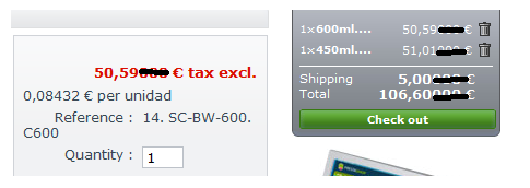

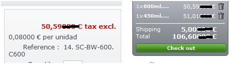

Antonio sc Posted September 14, 2011 Author Share Posted September 14, 2011 Thanks for your helping, after changing values in defines.inc.php from 2 to 5, I can display 5 decimal but not just in unit_price, there are 5 decimals in all prices in all blocks. Also the unit-price round to 2 decimal (0,08000 per unit and should be 0.08432 per unit) Have you any solution for it.? Thanks for your time. Link to comment Share on other sites More sharing options...
Antonio sc Posted September 14, 2011 Author Share Posted September 14, 2011 Sorry, I was wrong. I introduced again the unit price in the BO ( and display 0.08432). It is perfect. The only problem is all prices are displaid with 5 decimals, not just the unit price. (see attchment) Link to comment Share on other sites More sharing options...

zyko Posted September 15, 2011 Share Posted September 15, 2011 Ok, please replace the attached two js files in theme folder if you want to change the prices in product info page as shown in screenshot . Please take the backup of original files. themes.zip Link to comment Share on other sites More sharing options...
zyko Posted September 15, 2011 Share Posted September 15, 2011 the solution is for this Link to comment Share on other sites More sharing options...
zyko Posted September 15, 2011 Share Posted September 15, 2011 chk this screenshot Link to comment Share on other sites More sharing options...
Antonio sc Posted September 15, 2011 Author Share Posted September 15, 2011 Zyko,thanks for your time. I have replace the two .js files in theme folder and all prices are with two decimals, same as original prestashop theme. After that I also have changed define('_PS_PRICE_DISPLAY_PRECISION_',5); all prices are display with 5 decimals, looks like the zip.zile doesn't change anything. the result is like the attachment Link to comment Share on other sites More sharing options...
zyko Posted September 15, 2011 Share Posted September 15, 2011 where you put that files , in themes/your theme folder/js ??? after putting that file - even if you ('_PS_PRICE_DISPLAY_PRECISION_',5); cahnged to ('_PS_PRICE_DISPLAY_PRECISION_',2); the price on product info page would be shown upto 5 decimal point if you still keep ('_PS_PRICE_DISPLAY_PRECISION_',5); then all prices would also show upto 5 decimal points Thanks Delonix Link to comment Share on other sites More sharing options...
