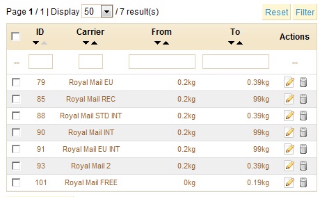

led-watches.co.uk Posted September 18, 2011 Share Posted September 18, 2011 Hello, I have been puzzled by this also for a while looking for solutions and searching forums and google and had it set up like you mention which is not great when a lower cost item can override shipping because of weight, I wanted to offer Gift vouchers and also Free shipping on certain items and a set category so I have sat down today and finally worked out how to offer free shipping, it works fine for me so I hope this post helps some people out. In short, you need to do something like this, I may not have written it in the correct order so change the steps around if I have, anyway set up a carrier first if you have not set one up. I have also attached an image of how I have my weights set up as an example incase its not clear when you get to this step. I could go in depth on all the shipping set up but this is regarding setting up free shipping so if you follow the steps below it will work, providing you have your other carriers set up correctly aswell. Prestashop version 1.4.4.1 Step 1: Go to: Shipping>Carriers> Name your Carrier e.g Free Shipping Tick the zones you want it available for Set Billing to According to Total Weight Set Out of range behaviour to DISABLE CARRIER (This is important otherwise it wont work) Save Step 2: Click on the Shipping Tab Select billing according to weight In the Fees box select your Free Shipping carrier and enter 0.00 for all the zones its applicable to. Step 3: Click on Shipping> Weight Ranges +Add New Select the Free Shipping Carrier you created Enter in your weight ranges 0.00 - 0.19 (Obviously, you can change the number to a lower value such as 0.0019 etc but this is how I have it set up) Step 4: Find all your products you want to offer Free shipping on and set the weight to 0.01 (Obviously, you can change the number but this is how I have it set up) Ensure all the products you want to charge for shipping are set at a weight of 0.2 and above Simple as that really, as long as you follow this method and use low values (high values wont work) and ensure your carrier is disabled and all your other shipping weights, zones are set up correctly shipping will be charged on the items you want and free on the ones you have set up. This way it also means you can have your Free Shipping items in any category. Obviously this is basic but it works as I have 7 carriers, 2 for UK, 2 for EU and 2 for Rest of the World plus the Free Shipping option. The way it works for me is perfect, obviously this may not suit everyone but it certainly is the simplest solution rather than messing around creating groups and so on until Prestashop develop a way to just tick the product for Free Shipping. On my site for example: Someone buys a gift voucher or a free shipping product then they get Free Shipping and 0.00 shows up in their cart, if they then add a item I charge shipping for, the Free carrier is then disabled due to the weight settings and the normal shipping rate comes into effect, if they add 2 products the normal rate shipping becomes disabled and my tracked service carrier comes into effect. I hope I havent missed anything out, as I am just writing this whilst its fresh in my mind while I am editing my Free shipping products. 6 1 Link to comment Share on other sites More sharing options...

bellini13 Posted December 14, 2012 Share Posted December 14, 2012 (edited) thank you for documenting your approach, the only thing I see incorrect on your range configuration is the overlap of the amounts, and that might be why you have to disable the carrier for out of range. For example you have these 2 ranges. Your "to" range is 0.19, but all your other "from" ranges are 0.2. Since the "to" ranges are excluded, you have a gap in that products weight 0.19 will not be considered. Royal Mail Free 0 to 0.19 Royal Mail EU 0.2 to 0.39 Instead you want to make sure there is no gap, by doing this... Royal Mail Free 0 to 0.2 Royal Mail EU 0.2 to 0.39 Edited December 14, 2012 by bellini13 (see edit history) Link to comment Share on other sites More sharing options...
